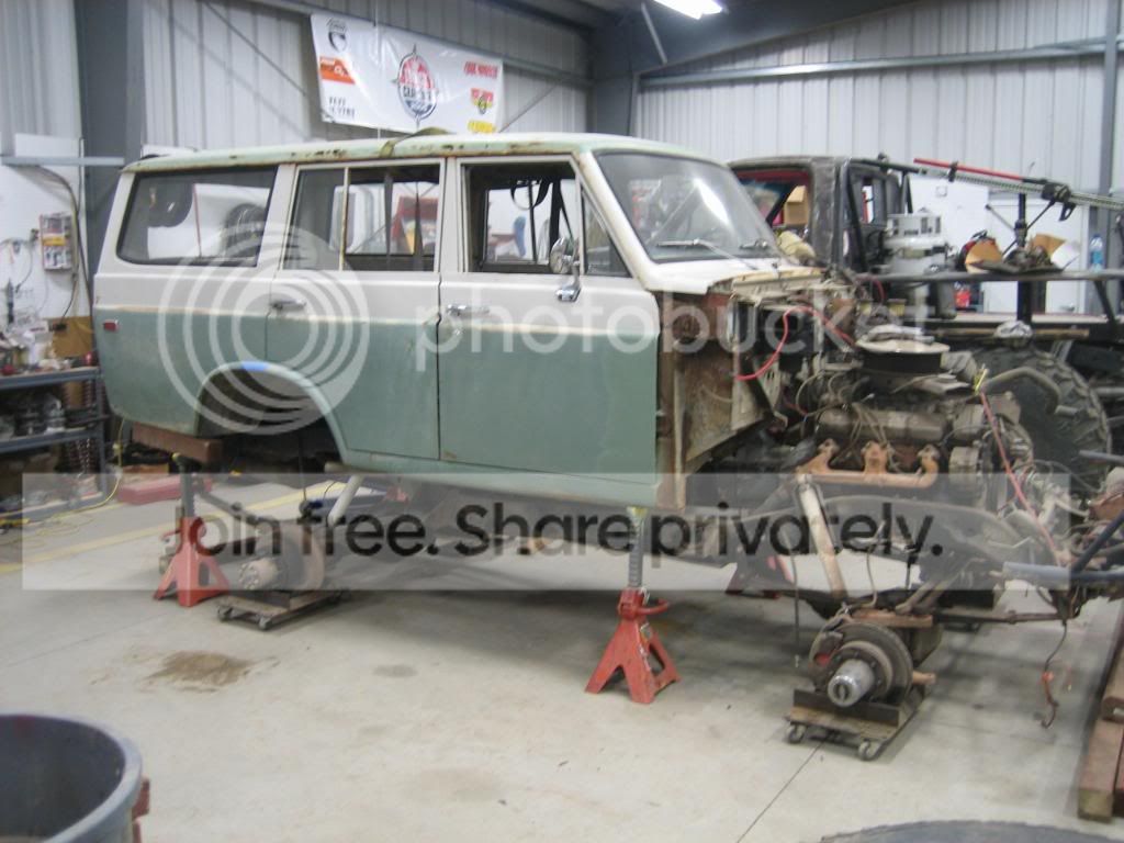

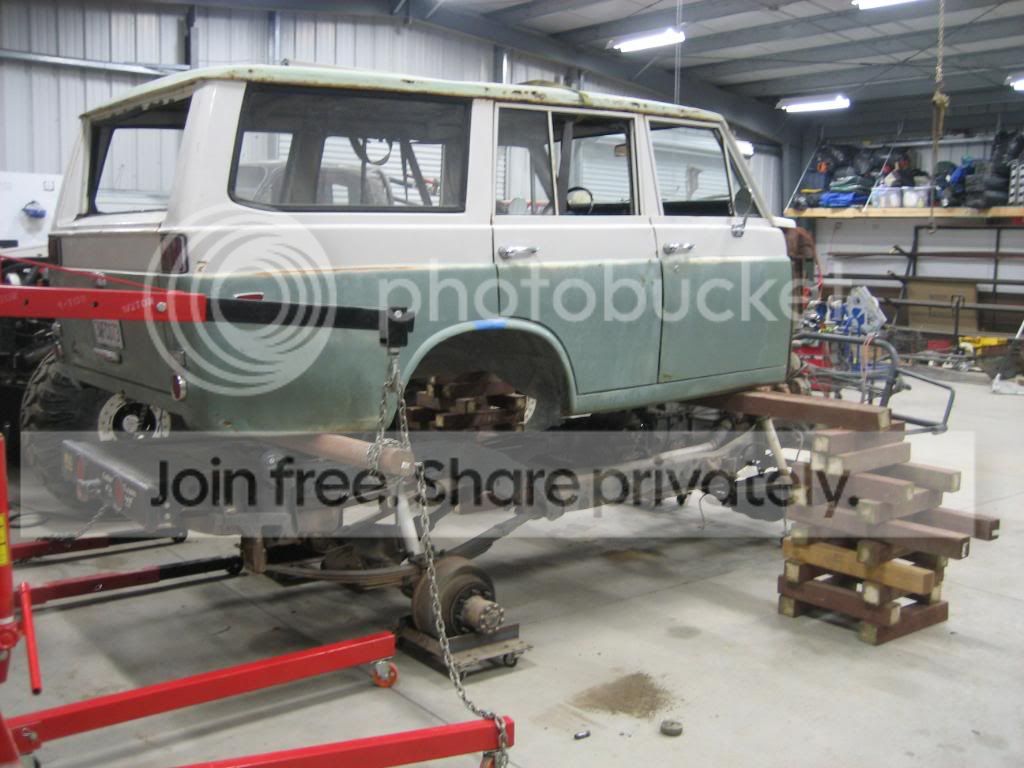

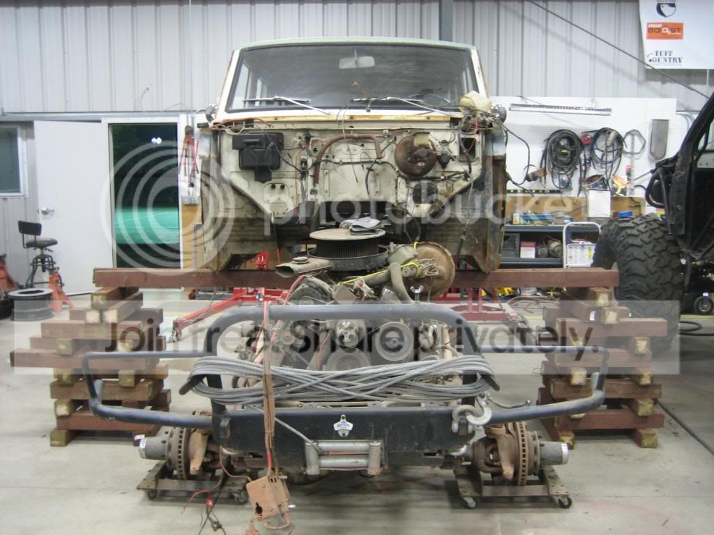

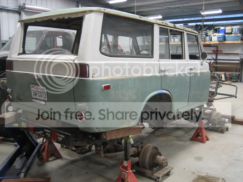

This is what I did once:
Used a hoist (manual chain driven) and chains and a strong ratchet attached to four points
I like that set up, looks pretty slick. Thought about doing something similar for top removal but I guess if I build it strong enough I can do much more with it.
