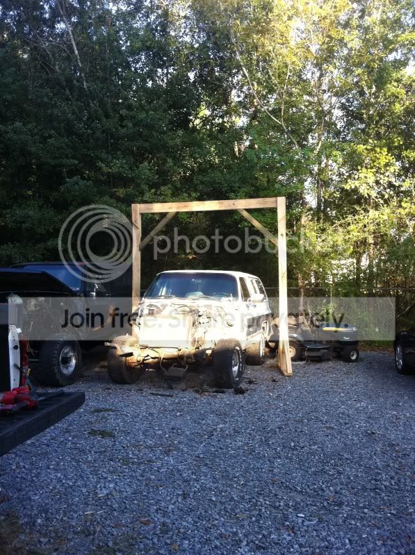

I like that set up, looks pretty slick. Thought about doing something similar for top removal but I guess if I build it strong enough I can do much more with it.
I doubled up rough cut 2x6 and used a 2x8 double header, I would even go bigger just to be safe (2x10). It went quite well. Put it down on those wheels and wheeled it through the garage into the back yard where it has sat ever since :doah:

Well, I ended up using DK5's idea, now I just need to get some straps and strap up the chain hoist and get this body off.
Are you taking the top off before you lift it?
I'm not sure how this will fare with that much weight. Keep in mind I had no doors, no interior, and no top when I did it. If you're going to lift it as is, I would have gone with a little more beef up top for sure (maybe 2x10 double).

Well with the brackets it should be fine. That design can hold a lot of weight. Just test it carefully first and go from there.

I plan to go very slow and only high enough to slide the frame out from under it.

Well my setup was a little different. I bought the body only and it was on a trailer. We put lumber underneath the body (bolted it to the body mount locations and jacked it up from the lumber (basically two double 2x6's 16 feet long).
I'm thinking you could maybe go under the rear wheelwells and up front maybe lift through the doors (under the roof).
Otherwise you can do what I did and bolt up some lumber in the body mount locations. You would have to jack it up though to do that.

Well, I got part of the swap done. I ended up leaving everything on the blazer, and even left the interior in the truck. I did do it a different way though. Lifted the front and slid a 4x4 under the body, then moved to the rear and lifted it and pulled the frame out some. Sat the back of the body on some stacked up tires, then moved back to the front to get it up high enough to roll the frame out. After the frame was all the way out I sat the front down on some big cinder blocks. Now I just have to make my big body dolly. I still haven't decided if I want to cut the blue body up or take it off...
