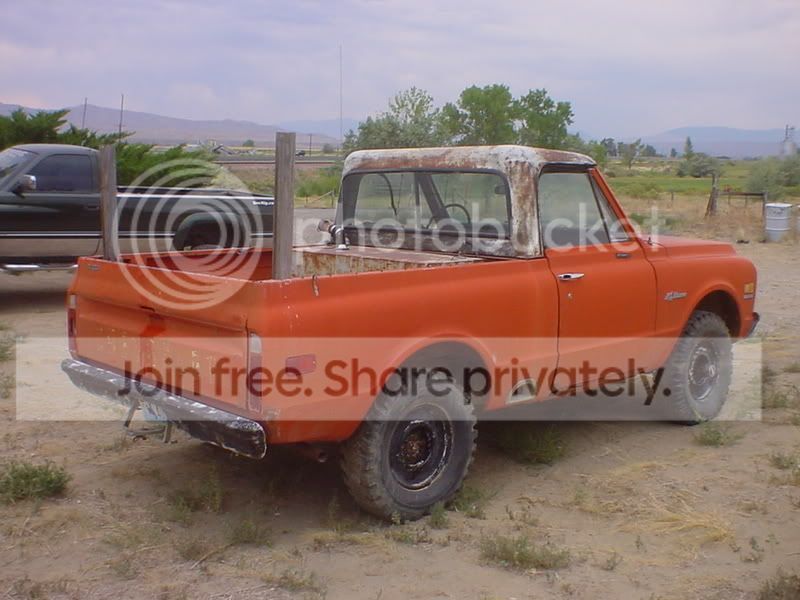

this was the halftop my k5 had when I bought it. Made by glasstite or something like that I think. They are pretty rare and pretty valuable, especially to the street truck crowd. I sold mine for $600

Thanks for that... Yeah, I remember the Glasstite brand as well. Forgot about that one.
Edit: Since Glasstite is still in business, I wonder if they could or would still make the Blazer parts, even though they're not listed on the website...???
