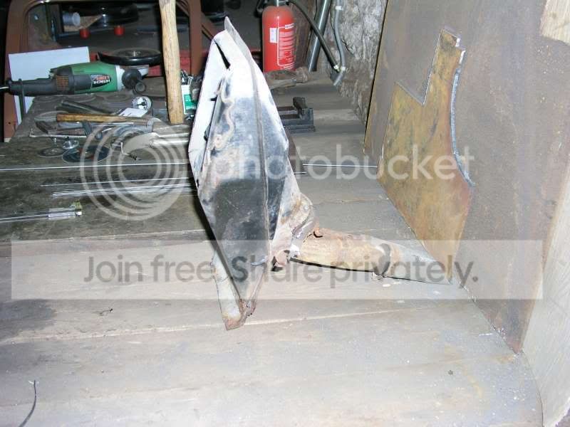

I posted this to my build thread, too, but no answers yet. So, anyone knows that what is the purpose of the metalbox at the fuel fill, one that's spot welded to fuel fill opening? Does it prevent fumes getting to passenger compartment, or to guide fuel spills to ground?
Oh yeah, it's an -82 Suburban. And that box is sandwiched between the outer and inner sheet. I go and take a pic.
I would imagine it is just to secure it in place while keeping it from rattling or vibrating while driving. If it could rattle to the point of rubbing and creating sparks around that cap, it could theoretically ignite the gas fumes. Even though your truck looks like its equiped with a diesel engine, its an assembly line thing, if one gets it, they all get it. Just like dual tank equiped trucks. Even though alot of trucks only have 1 tank, they still have that little hump on the other side just inside the bed.

Reason I'm asking the purpose of that box because I'm relocating the filler opening to the left side of the 'Burban, front of the rear wheel opening. And there's no way that box fits there.
But if it's more of a gasser related part, I won't bother making any to diesel 'Burban.
