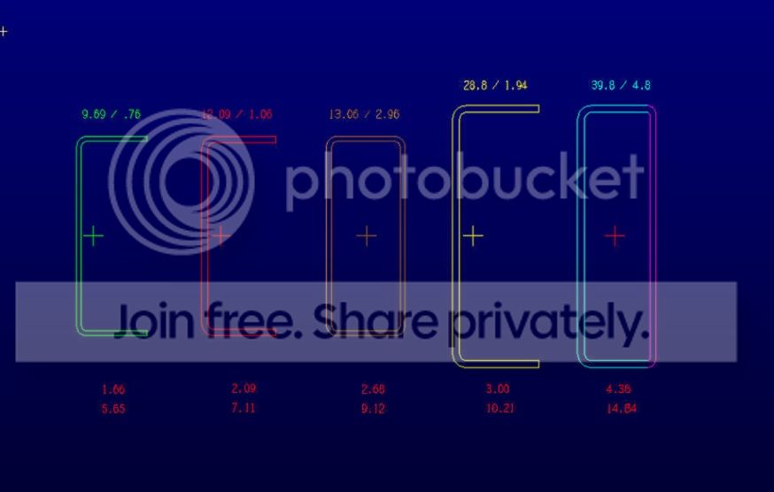

Left to right, based on dimensions I've taken from trucks I've owned over the years:
1979 1/2 ton SWB 2WD frame---about .153" thickness
1985 3/4 ton Suburban 2WD frame---about .203" thickness
1979 1/2 ton SWB 2WD frame, boxed using more .153" material
1980 3/4 ton Crew Cab 2WD frame---about .224" thickness
1980 3/4 ton Crew Cab 2WD frame, boxed with .187" material
The numbers across the top (the 9.69 and .76) are the figures for moment of inertia over the major and minor axes for each cross section (units are inches to the fourth power). Suffice to say a bigger number indicates more strength. Numbers across the bottom (like the 1.66 and 5.65) are the cross sectional area (square inches) and approximate weight per foot (pounds).
The last iteration of the truck used pretty much the one on the far left---1/2 ton 2WD frame, .153" thick, no boxing. What's under the truck now started off as the fourth one from the left, except about a 2 foot long section under the rear of the cab (where the rear 4 link bars tie into the frame) that resembles the section on the far right.
By my math, I just about doubled my frame weight and in return nearly tripled the strength. (More importantly, it put that crew cab frame to good use, as it was previously just cluttering up the yard.) I think I'm happy with the result...at least for now.

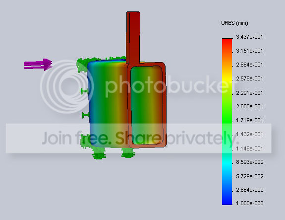

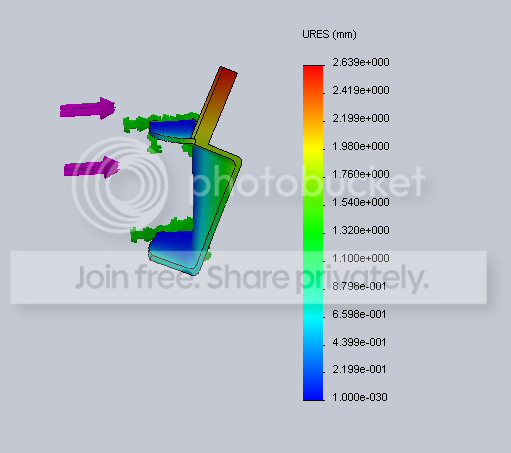

I think to find the max torsion in a c-channel you just break it up into individual rectangles and find max torque for each
I imagine this will give a more significant gain
I'll do this latter
Maybe I can run a simulation in solidworks, I'll see about that also
Think about it though, I think that twisting the frame would bend it somewhat also though, you wouldn't be able to have it loaded purely torsionally.
Did it real quick, quite the difference
