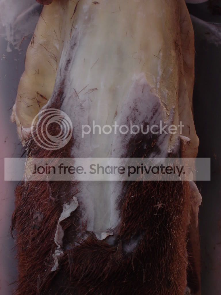

A good pic of a strip of clean hide. You can see the still attached grain on either side, as well as a piece of it on the fur. I'm showing lots of pics of the graining steps, because graining is probably the most difficult part. You need to get it all off, or you will have stiff spots.

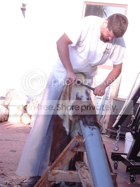

And here's an action shot of the scraping/graining process, youll want some sort of apron, like a trash bag or something, or your clothes will get nasty with the lye water. I made mine with a piece of heavy visquene tied around my waist. It happens to work very well, at some point I'll probably try to fashion an actual 'apron' out of this stuff with duct tape and whatnot.

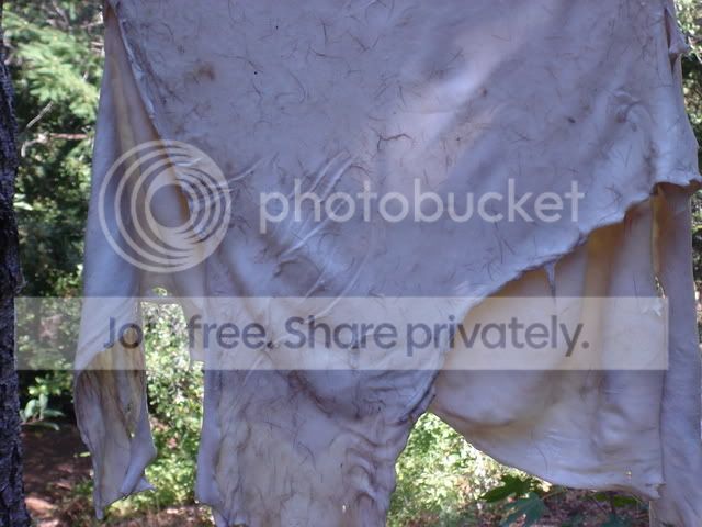

Here's a photo of a rinsed hide, you can see knife marks made by a 'hide slasher'. These show up in your finished product. That is why it's important, when skinning your critter, to get it started, and then PUT THE KNIFE DOWN! Use your fingers, fists, elbows, whatnot to separate the hide from the carcass. There's not much you can do if you are getting hides from fellow hunters, other than offering to skin their deer for them.
