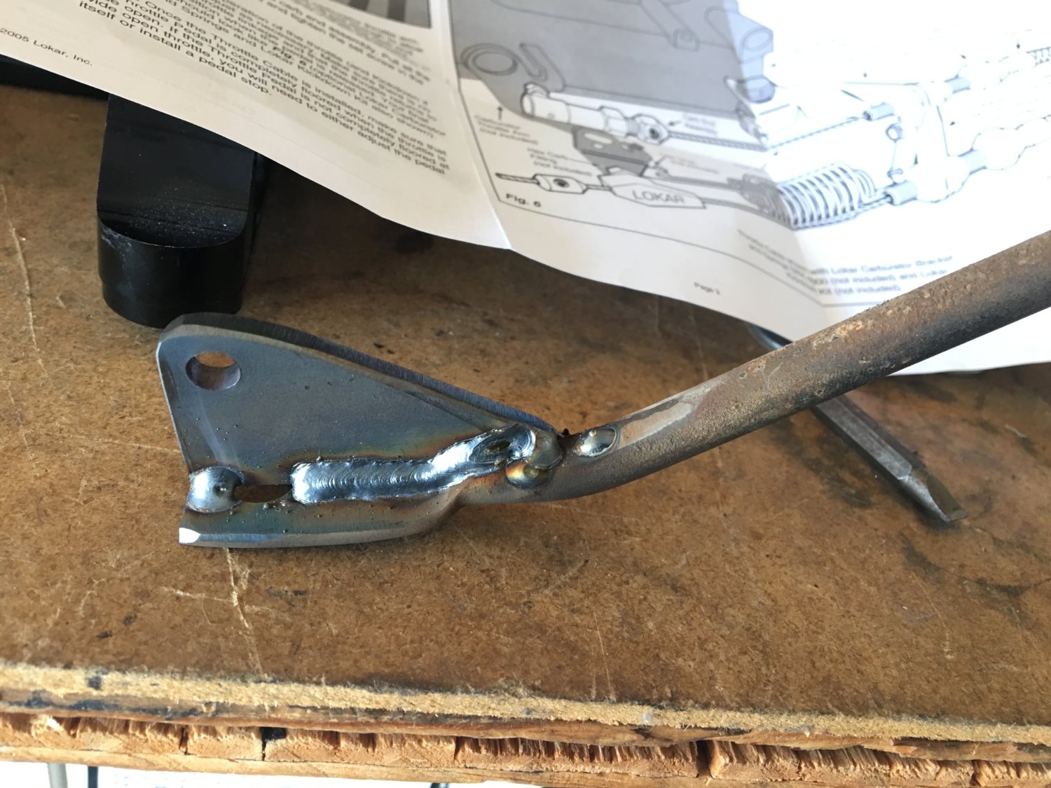

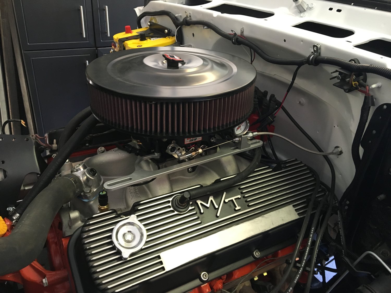

Here's the setup I use on both K10's, one with FiTech and the second with pro flo 4.
Lokar Cable (longer are available and they're cut to fit) https://www.summitracing.com/parts/lok-tc-1000ht

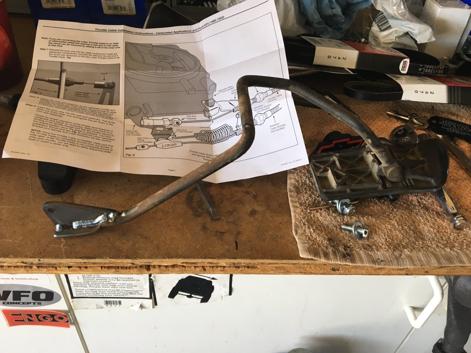

Remove the gas pedal and install a tab for the lokar cable clevis.

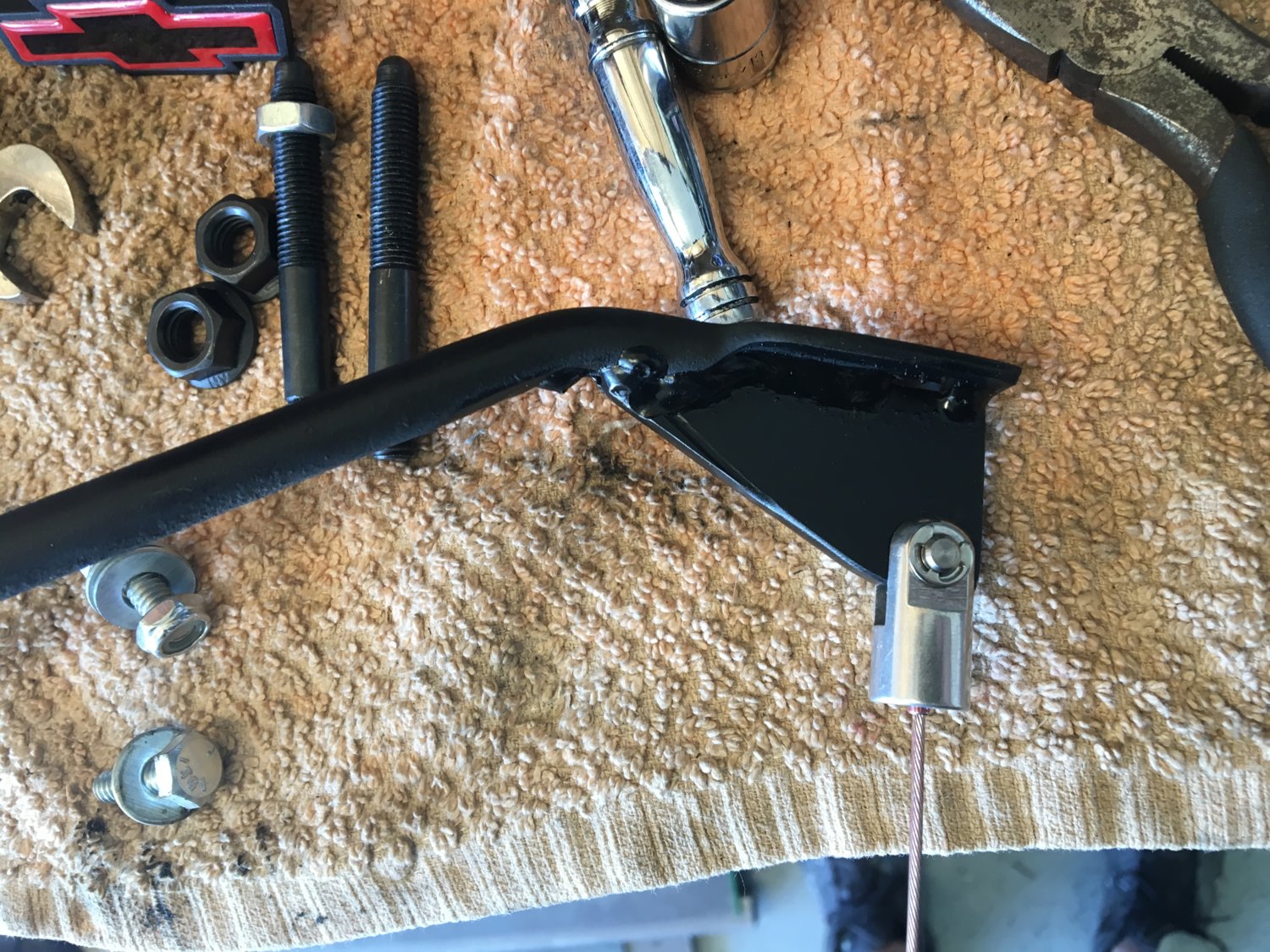

painted and the lokar cable/clevis installed

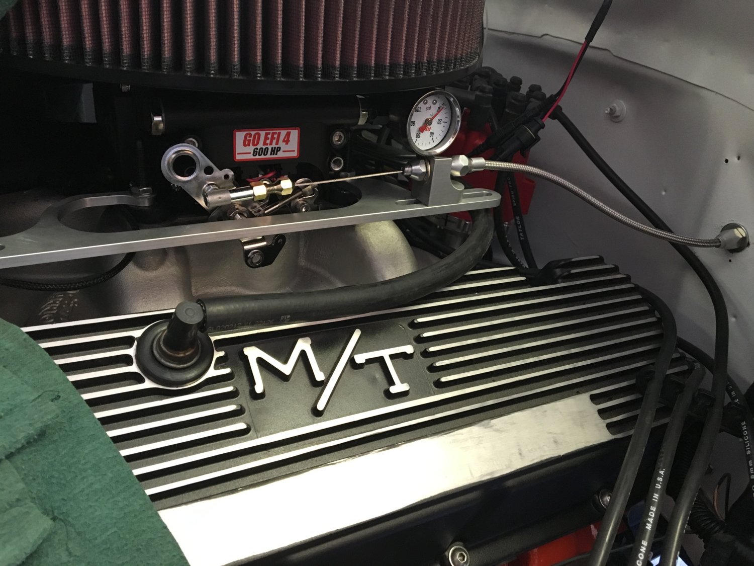

I used the stock throttle cable hole on the firewall with a couple washers. Disregard the attachment point on the throttle body linkage side, I moved that up later.
