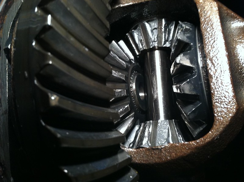

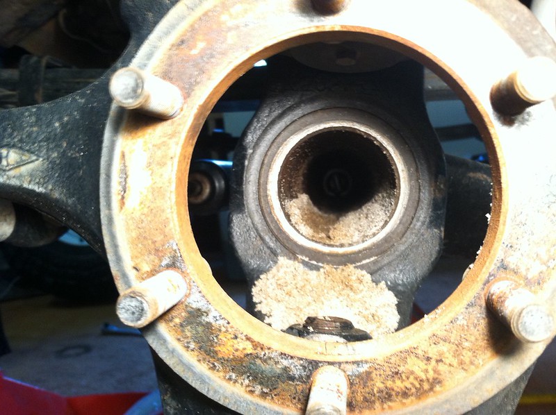

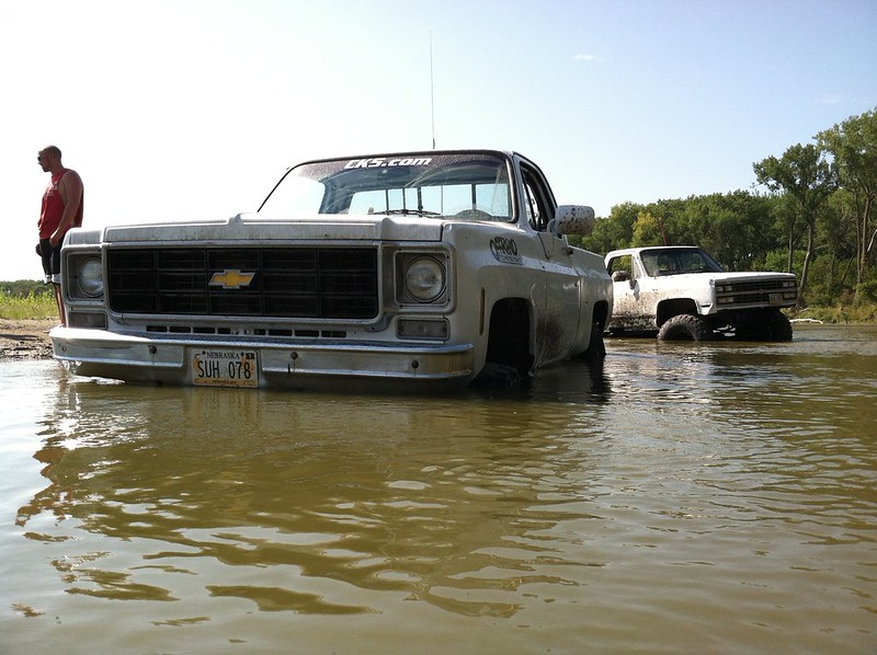

I feel your pain. I had to learn the hard way that sand and water do not mix, although I think you have me beat.
I sunk mine in a river and broke a bunch of stuff. Front spider gears & carrier, brakes were messed up and full of rocks and sand, both diffs full of river water, all bearings and seals were destroyed. It was a mess and I don't think I will play in the water/sand anymore, but who knows :haha:.

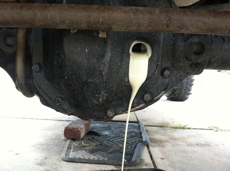

That sucks, my front diff came out thick and black. Haven't checked the bearings yet, I was planning on a re-gear soon anyway. I'm definitely not done in the water just not so deep intentionally.

Got the truck running again yesterday. Its been hard to get anything done to it with working night shift recently. I took a video of the rear when I changed the oil because it was so strange looking to me. the front just came out creamy but this looks like wet concrete and only looked angry when blasted with brake cleaner.
