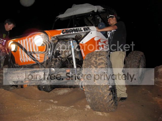

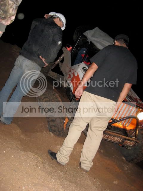

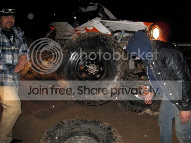

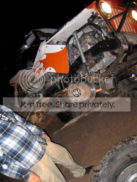

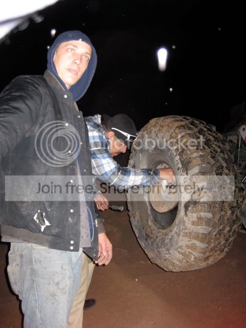

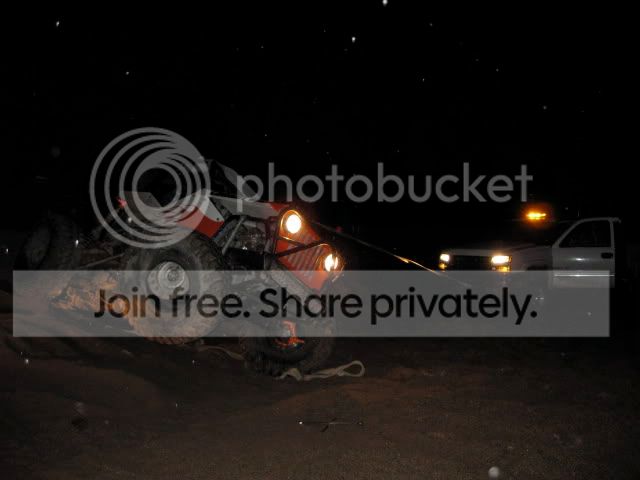

So on this one.. I came down hard and put a tire off the bead. I am running hummer bead locks that are 16.5's but I have not yet put the bead lock insert in:doah: Ill get on that now. When it came down.. turns out more than the tire was wrong as i went to move it and it would no-go. The problem was my diff had went into my engine on the landing:doah::doah::doah: The result was my oil pan and my starter were destroyed. The oil pan was on it was just the casting around the sender on the bottom of it, so no worries there but the starter had to be delt with.
So I went and grabbed my 06 and trailer and wheeled it down into the wash, the whole time hoping I was not going to wind up with three stuck items out there:haha: Truck did fine, disconnected the trailer, hooked a strap to the buggy and pulled it over to change the tire. While there I grabbed my spare starter from the tool box on the 06 and swapped it out. Thank god for all three vehicles I have using the same motor..spare parts are easy to carry!
It started pouring but my buddy and I got it changed out real quick. Over all it was fun, now I need to go install my new longer bump stops that I thought I wouldn't need last night because I told my self I would take it "easy" ont he buggy:doah:

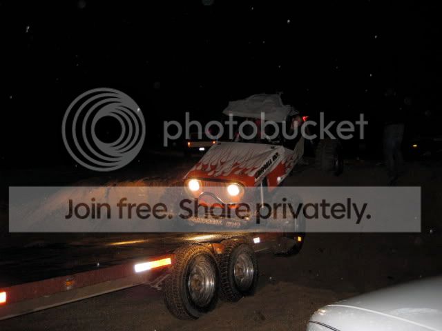

Quick change of the starter and Im back in business and headed for the trailer.
So fun in all.. Im going to install my new bump stops, play with my front shackle angle, actually bead lock my bead locks..add a pwr steering cooler and Ill come back for some day time vids :)
nice wheelwalk in the 2nd vid -- 2nd jump.... and did you have any brace under the Jeep while working on the starter?
No... but I did have two different straps on the buggy to the truck, one to each tow hook and on two points on the buggy. Added the second strap to change the starter, was not worried while changing the tire with just one though. Not the best scenario.. but not the worst. I would.. not recommend it:crazy:
Sometimes you gotta make do....that second strap is a little insurance over just the one I saw in the pic.
No-one got hurt so all is good.
