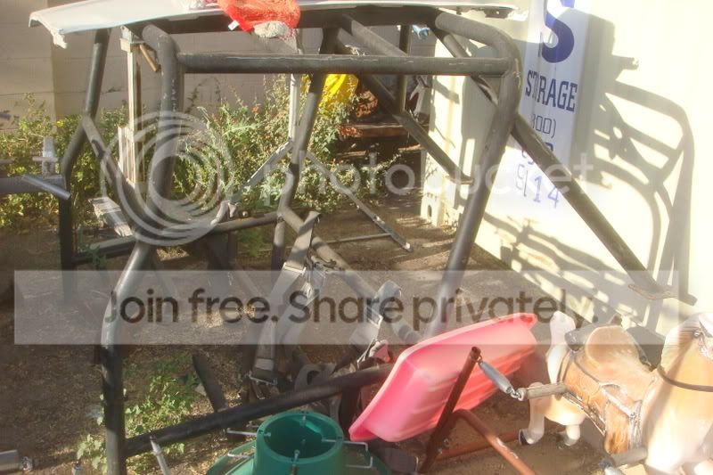

cage from craigslist, 300.00 has seats and seat belts too!

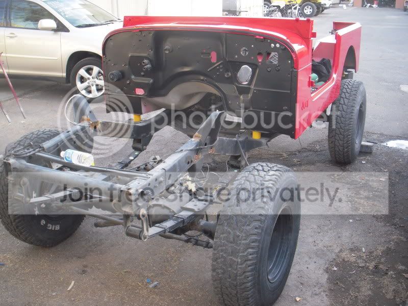

the chasis, I have already done the spring over and painted and cleaned everything

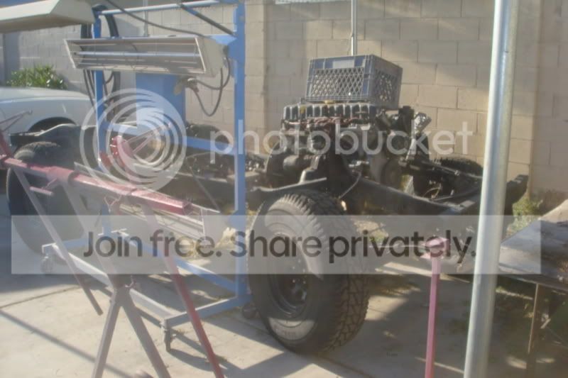

and the tranny and t-case is back there somewhere

got the old motor mounts out, ordered new ones

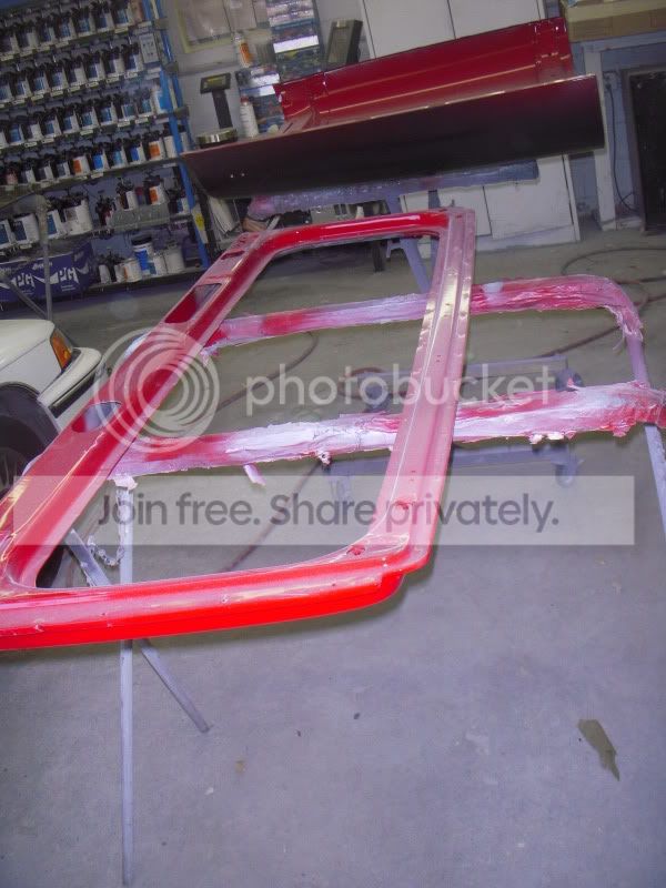

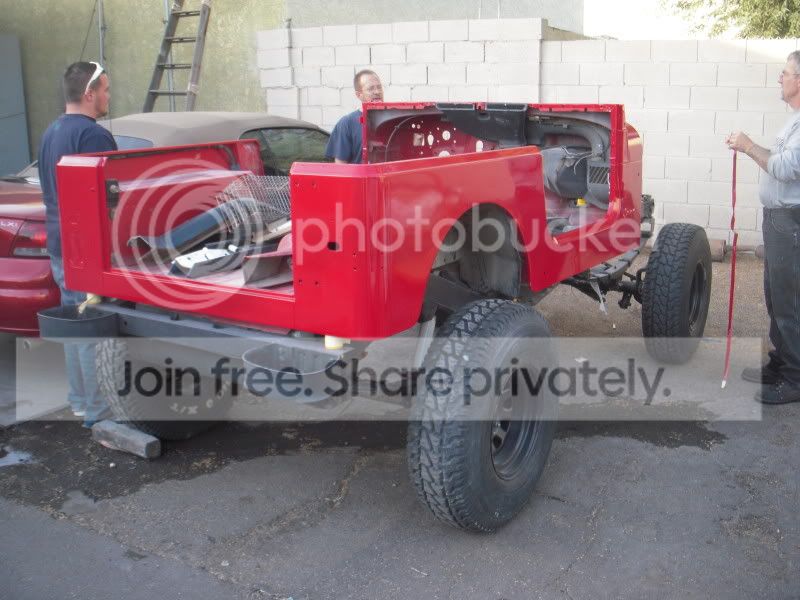

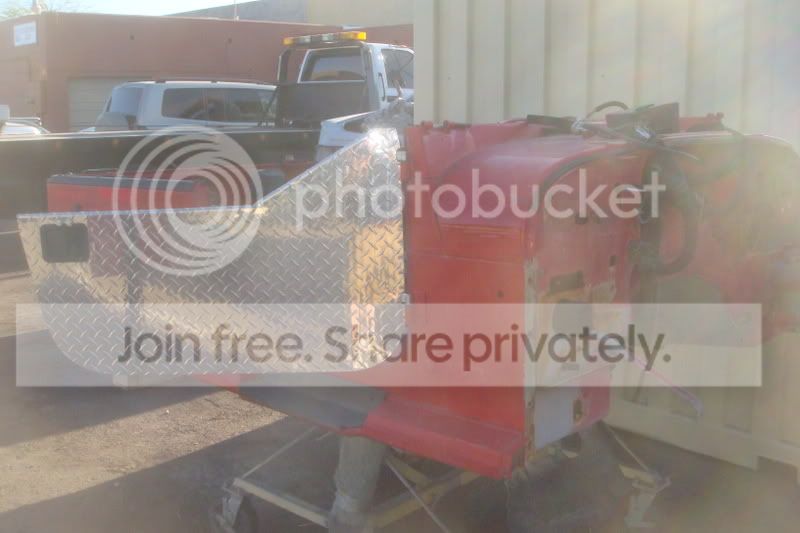

got the body straight, dents out and tub in primer and a little guide coat, new body mounts on. Just picked up a yj harness since i am using a drivetrain from a grand cherokee. Got a new housing up front and had 4.56 gears stuffed in, got it back and put new seals, bearing and ball joints in her and welded on the new spring perches for the spring over and new springs on. I went with stock new yj spring up front for the spring over so the ride should be nice. Also the cage is back from powdercoat so ill get those pics up
so.. forward progress it is.
My oldest is 7 so I'd only get 9 years to "work out the kinks" :doah:
Either that or you could build him a 9 year Blazer. :D

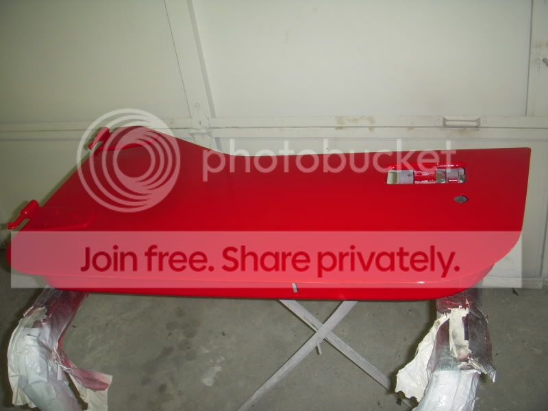

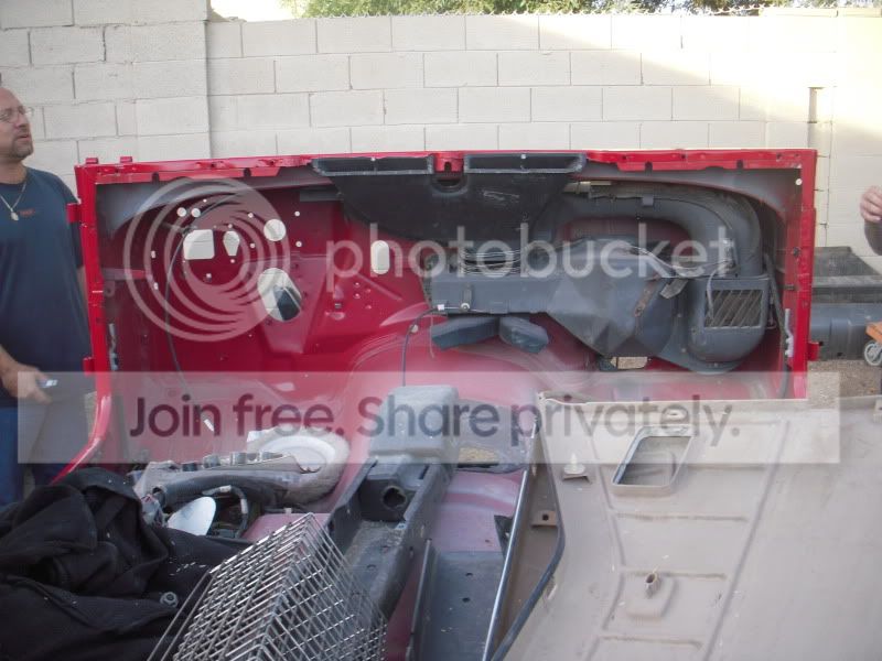

got her painted up, little problem on the windshield frame but ill reshoot it. I think I have a helper, so the herc and dash should get yanked out of the parts jeep tomorrow for me, this weekend ill weld up the new motor mount brackets and mock the wiring harness. Paint is just single stage nothing fancy. I do want to put some satin black on the center of the hood though.
