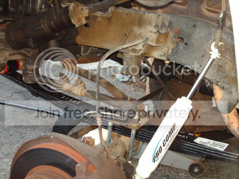

Ok so ive been tinkering around with this truck for a few months and finally got around to doing some REAL work on her... im proud of one days work so far.:D

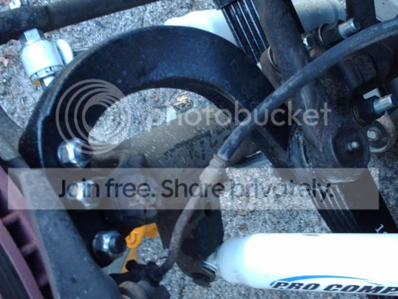

Today. 4 inch pro comp Suspension Lift. (front springs rear blocks) *Shackle Flip to come SOON*

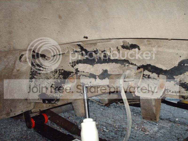

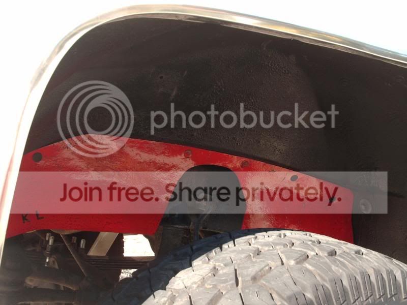

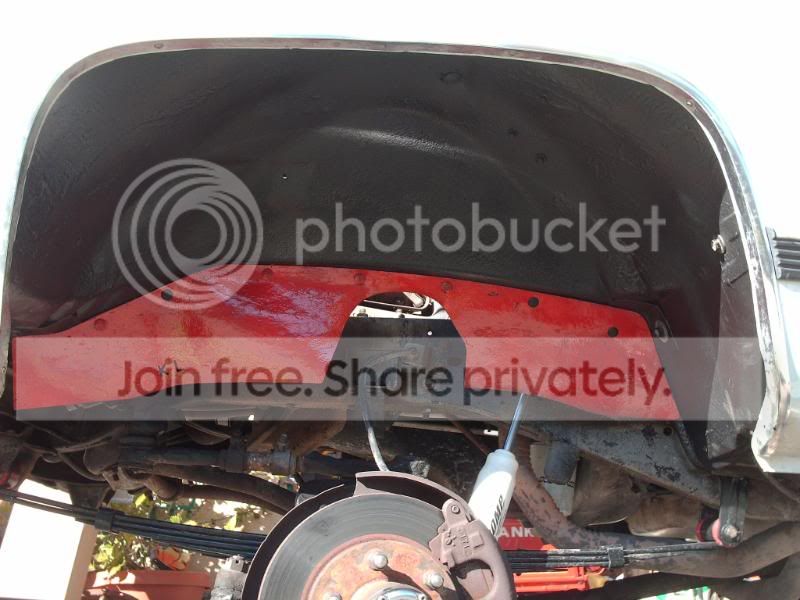

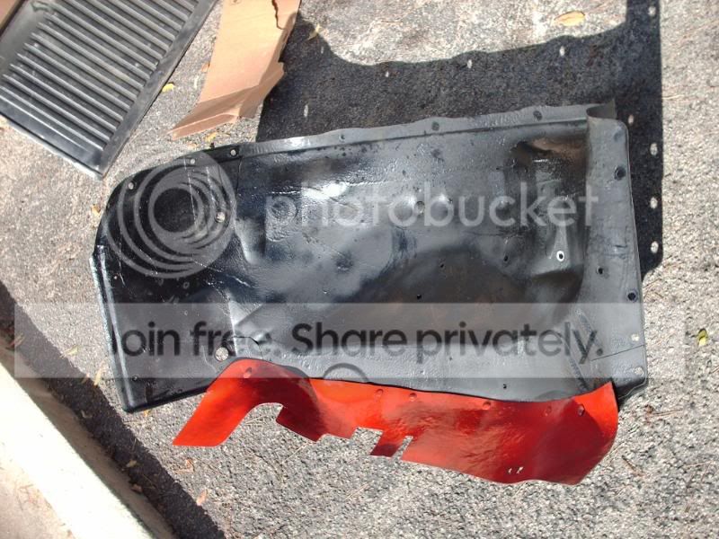

Started Tearing out Wheel Wells and reline and paint.

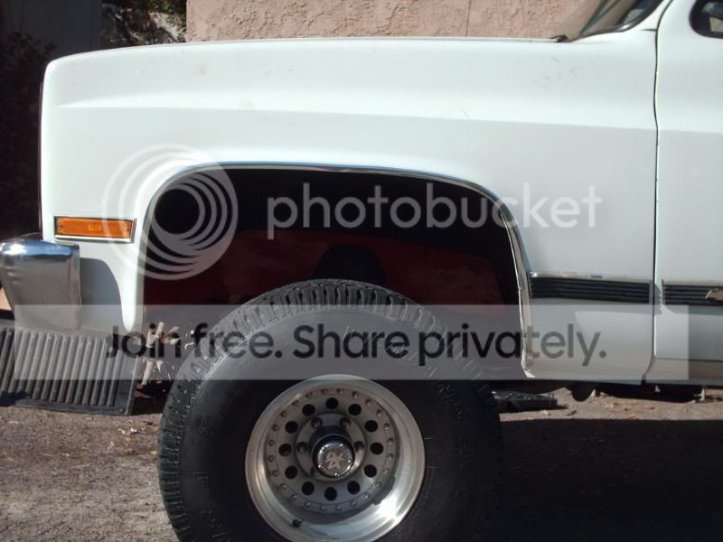

And now to touch up the Wheel Wells
Not bad for a start eh ! :D

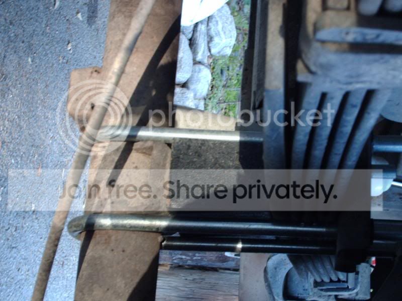

With the 4" lift, you'll need brake hose relocation brackets, or new longer hoses. Probably need to clearance the front D-shaft CV joint, and also check the rear D-shaft to pinion angle.
Oh snap. Forgot about rear angle. Should be ok tho. I'm going to garage now to finish her up. Post pics in a few hours. ;)

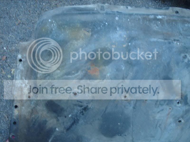

Finished up the wheel wells today

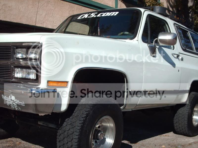

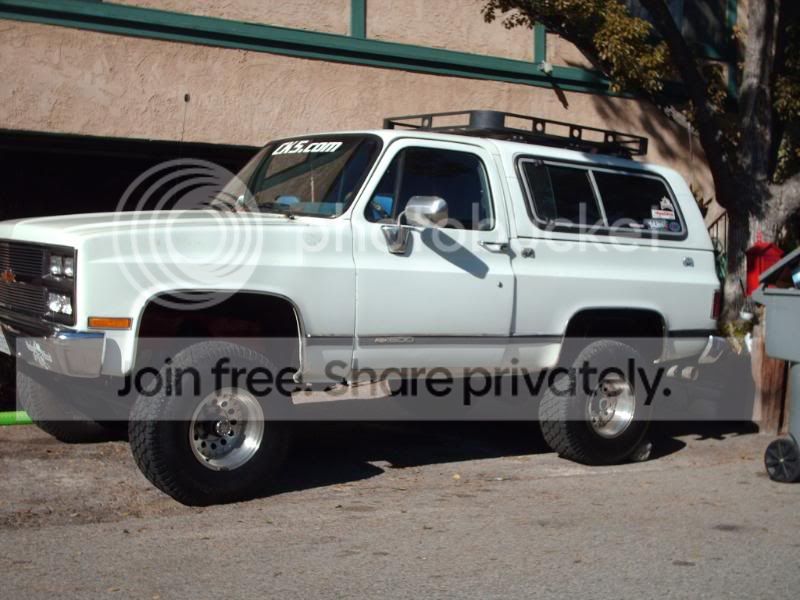

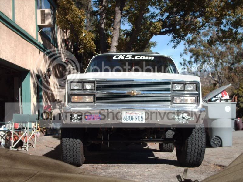

Heres the new lift and wheel wells DONE ! :D

Looks great! So that's what my white '85 looks like with a lift, eh? Cool...
ya man it looks bitchin... i love the lift... rides great too ( well like a truck !) :haha:
It do look good. Pro Comp kits are sprngs and shocks in front, blocks in back, right?
I'd like to lift mine but wanna do it right. I rode in a Blazer that had all blocks all around and man, it was rough!!!
Ya its front springs and shocks with rear blocks. I like it. Can be a little rough on a city freeway but hey its a truck.
