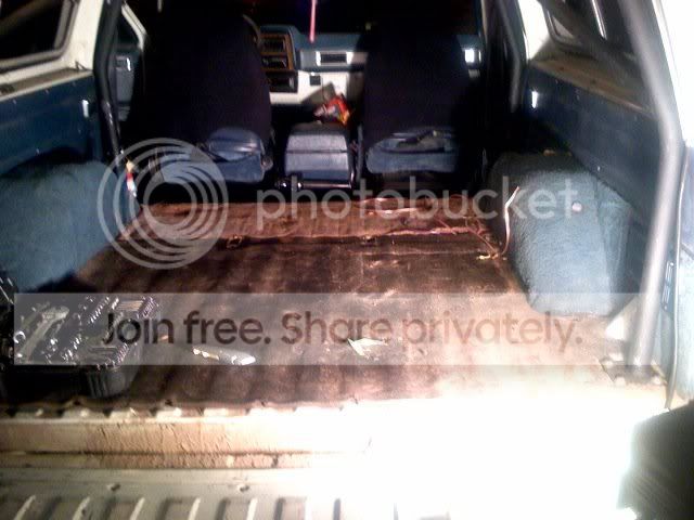

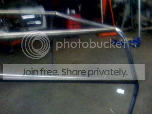

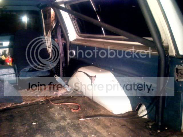

took out all of the carpet this past to weeks and Heurculinered the ENTIRE interior. replaced cab carpet for now with black. and installing sheet matal bed liners in rear. starting to look good... got my roll cage in now too. post pics tomorrow ! :D

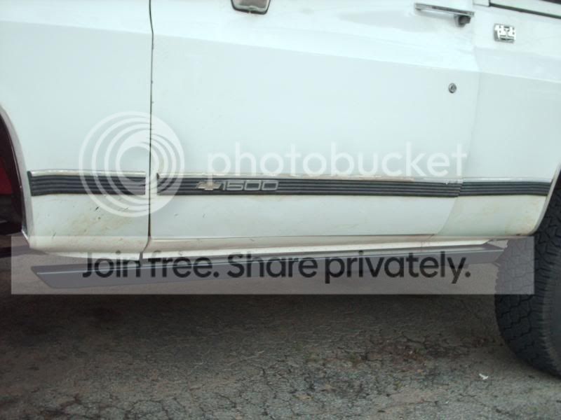

i finaly got off my lazy butt today and installed the rock sliders i got for Blazenofroad.com
i must say i am impressed !
:D

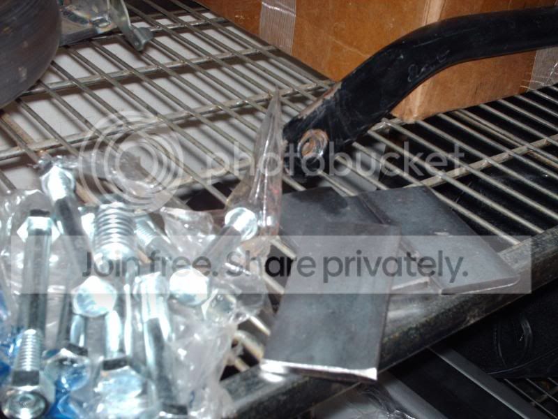

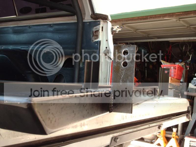

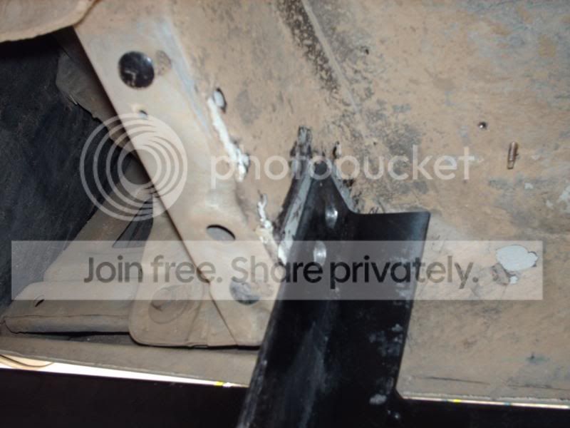

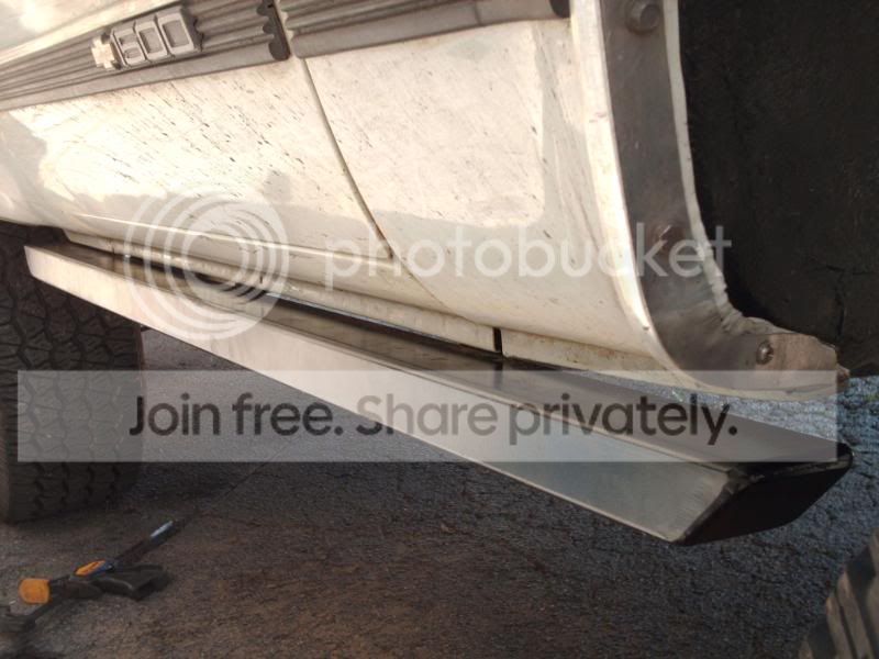

ok so i got these new rock sliders painted them the other day and was ready to drill and mount them today
i measured and marked for drilling.... then drilled.

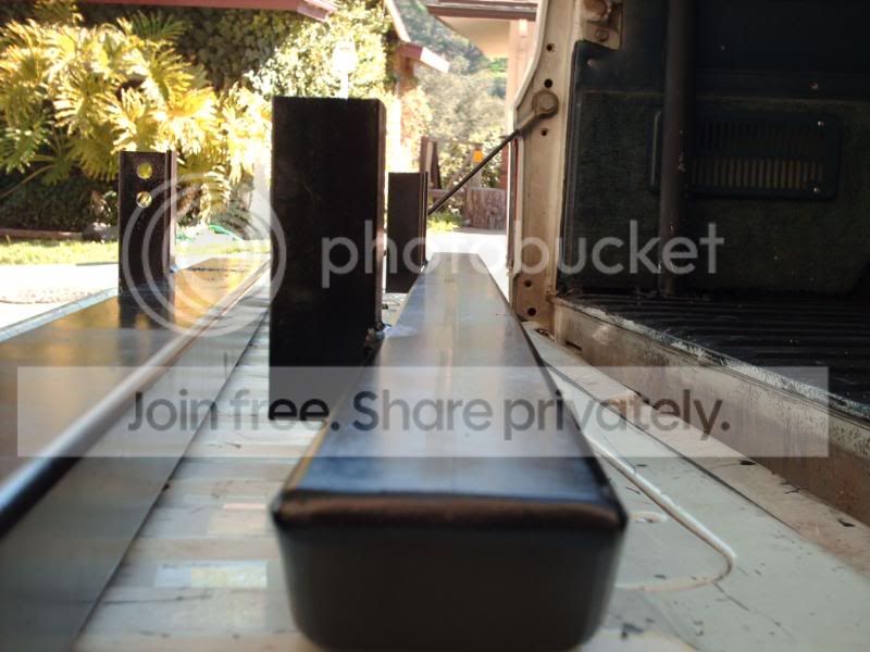

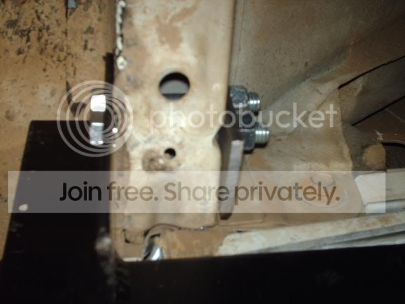

put them all together with the hardware included and stood back to take a look.
I was stoked to finaly be done. :D

Those sliders look great and the price is right too! $149 for a Blazer or $249 for a Sub.. can't beat that.

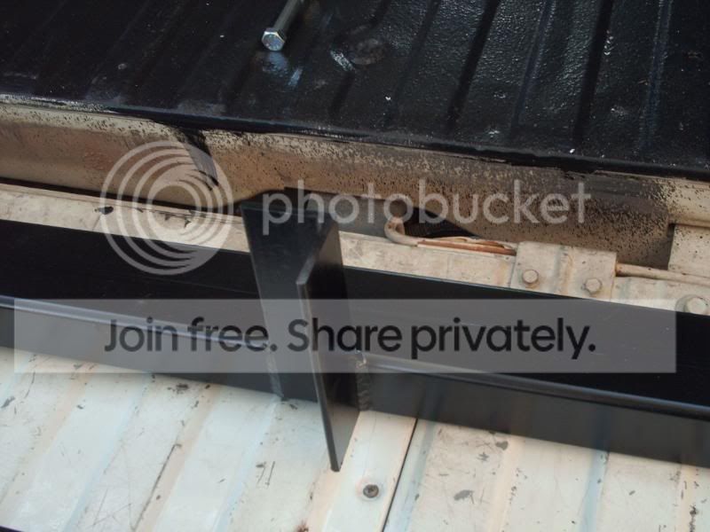

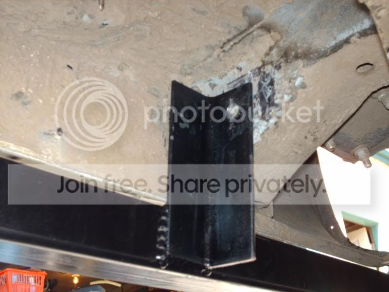

Matt, thanks for the PM and the pics. I take it you had to drill the holes on the slider brackets as well as the holes in your trucks body supports? Also, why only one bolt on one end and was that the front or the back mount?
Also what is the dimension on the square tube? 2x3?

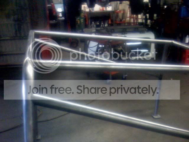

Are you planning on adding more tube to that cage?
Yep im actually gunna do the cab next week and mount new seats to the cage. =] ill be sure and post all that too.
No Problem =]
yep you have to drill all the holes yourself. the reason i only put one was that is all i could "easly" fit. if i did a little adjusting and hammering the Sliders up more toget tem closer to the body i could have fit two but i liked them seated a little lower.
its the rear mount
yep i believe it is 2x3.
Also jsut a side note. when you order them Jesse ( blazenoffroad) will contact you and ask for the length that you would like... such as if you have cut your fenders or anything to that effect.

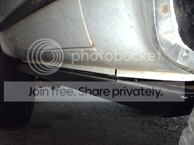

Did you consider getting the ones with the tube step? I am planning on adding or having Jesse add a set of removable U shaped drop steps. But I was wondering if the tube steps would act as an additional rock/stump/tree pusher like the DPI sliders and keep stuff out of the door. From the looks of it the widest part of the body/door sticks out farther than the base sliders. (Of course the last thing I need to do is make my Blazer wider :D )
For that matter why did you choose these over the DPIs? Their base slider, just a round tube with the same type mounts as Jesse's, is $99.
all good questions....
yes i did and still am considering some type of add on... the last few days at school ive just been sketching up a few ideas :haha:. As for them adding Rock/Stump/Tree pushy-ness.... idk. :D but also by adding something i would keep that in mind.. i wouldnt put just a simple "U" step. to me that defeats the purpose of the Rock Slider. and yes i was also thinking a bout the width of the blazer aswell :D
As for why i picked these. Ive bought lots from Jesse and i Really like the design of these. i guess just personal preference. :rolleyes:
Ya Ive Never liked the look of tube sliders on blazers. Thats why When I order mine I am gonna get the Blazenoffroad ones.
