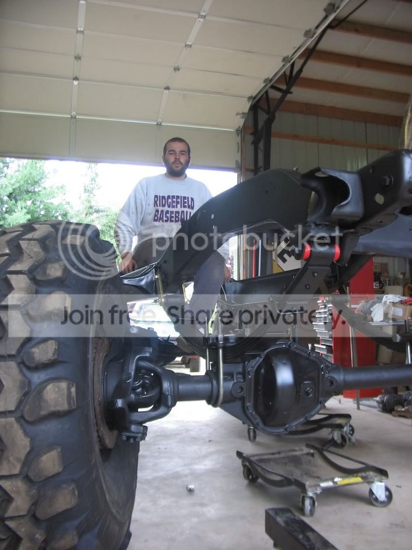

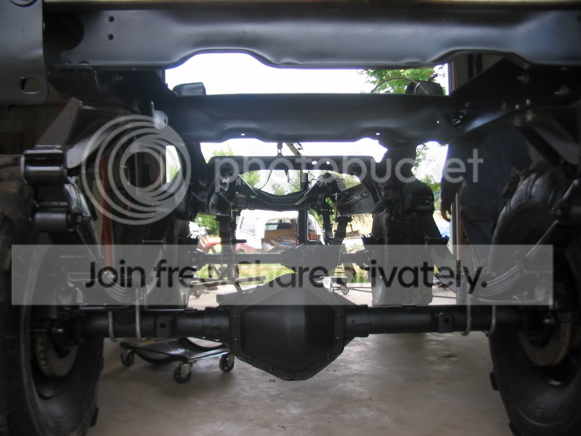

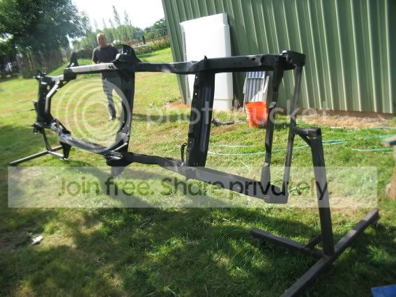

I've been looking around on CK5 for quite awhile now. I've seen several buildup threads and thought I would kind of show what I've done. I'm just a 19 year old out of high school last year and totally took apart my blazer and here I am. Got my cab sitting on my extra frame. Just got my new frame done sandblasting yesterday and painted yesterday. Pulled the axles out of the shop today and get them all cleaned up and ready to paint. Hoping to get my cab back on in the next couple of weeks then I'll post some pics of it with my 42's. Here is a few pics to show you guys where I'm at. Not real exciting I know, but my first big project and I'm having a blast.

It's funny, at first I felt like I was reading about my own build - I'm doing a frame off overhaul with similar lift and tires, I'm even using the same rear wheel spacers for my H1's. :rotfl:
Post up some more specs about the truck.
looks good. those are huge spacers on the 14b! whats with the extra set of perches on the 14b? they are on the same plane as the diff cover. cant wait to see more progress
Ya, I got the H1 beadlocks hence the reason for the big ol' spacers. Those aren't extra perches, that is the mount for my shock.

Looks good, but you might end up needing to address the rear shackle angle. It looks like if you hit a bump, the shackle could go the wrong way
you are going to want to fix your rear shackle angle...maybe with the body on it it will correct it. looks very sweet!
heres my shackle angle:
Yeah I realize that, when I sit on it, all 250 lbs of me, it goes down some and I know my cab weighs quite a bit so it should go down. Anyways, if it doesn't work how do I go about making the angle better.
:grind: :weld: :hack: :grind:
Or you can just redrill the holes on your frame for you flip and move it up some.
the weight will fix a little, but right now its too straight, you are going to need to move the mounts like 5" forward..no biggy
