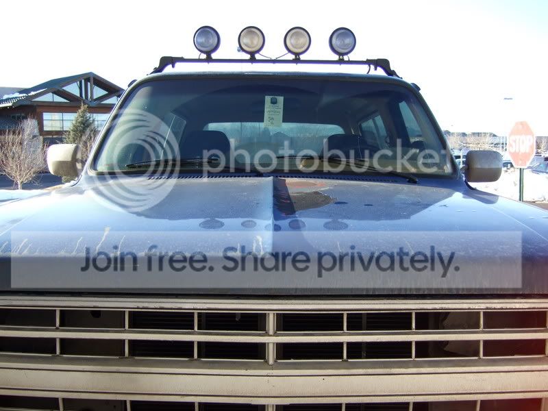

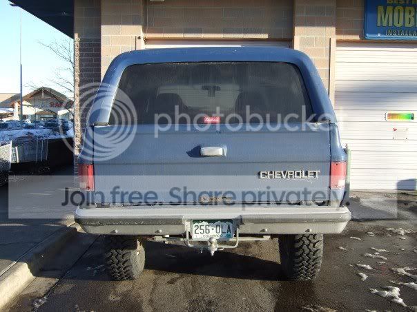

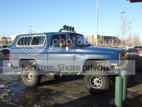

Well I figured I might as well start one so I can keep track of my progress. So here is what I am starting with: 85 K5 carbd 350/700R4/208, 10 bolts F & R w/3.73s, 6" Procomp Lift.
Here are some pics of when I got it:
My plans are 1 ton axles detroit in rear/ARB up front, 39.5" Iroks, Fuel Injection, full roll cage, dual batt setup, 12000lb winch, custom rear bumper, Auto meter gauges in custom bezel (like Ryoken's), tube doors or half doors, TH400/205, etc......
