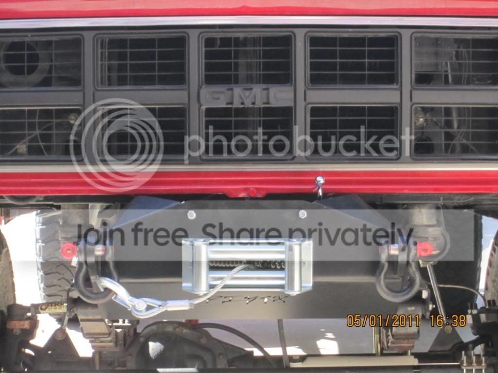

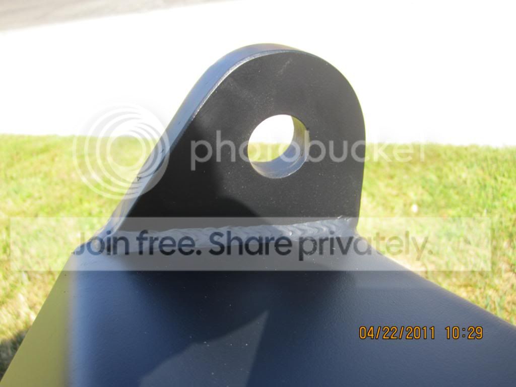

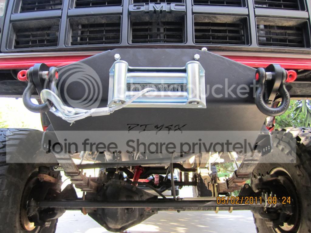

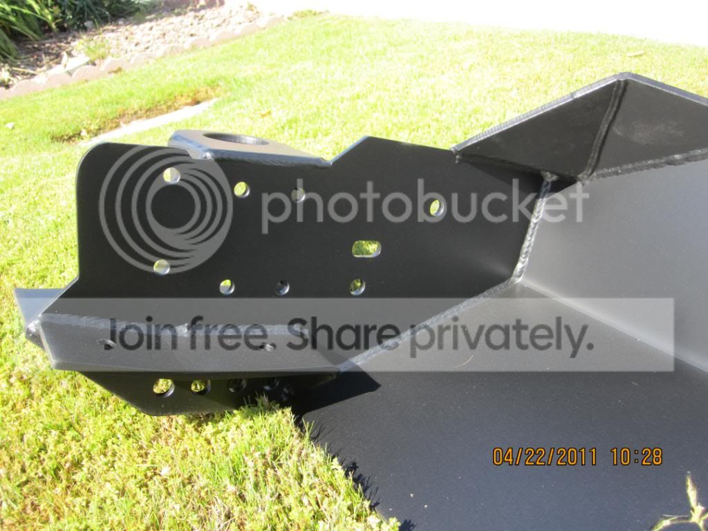

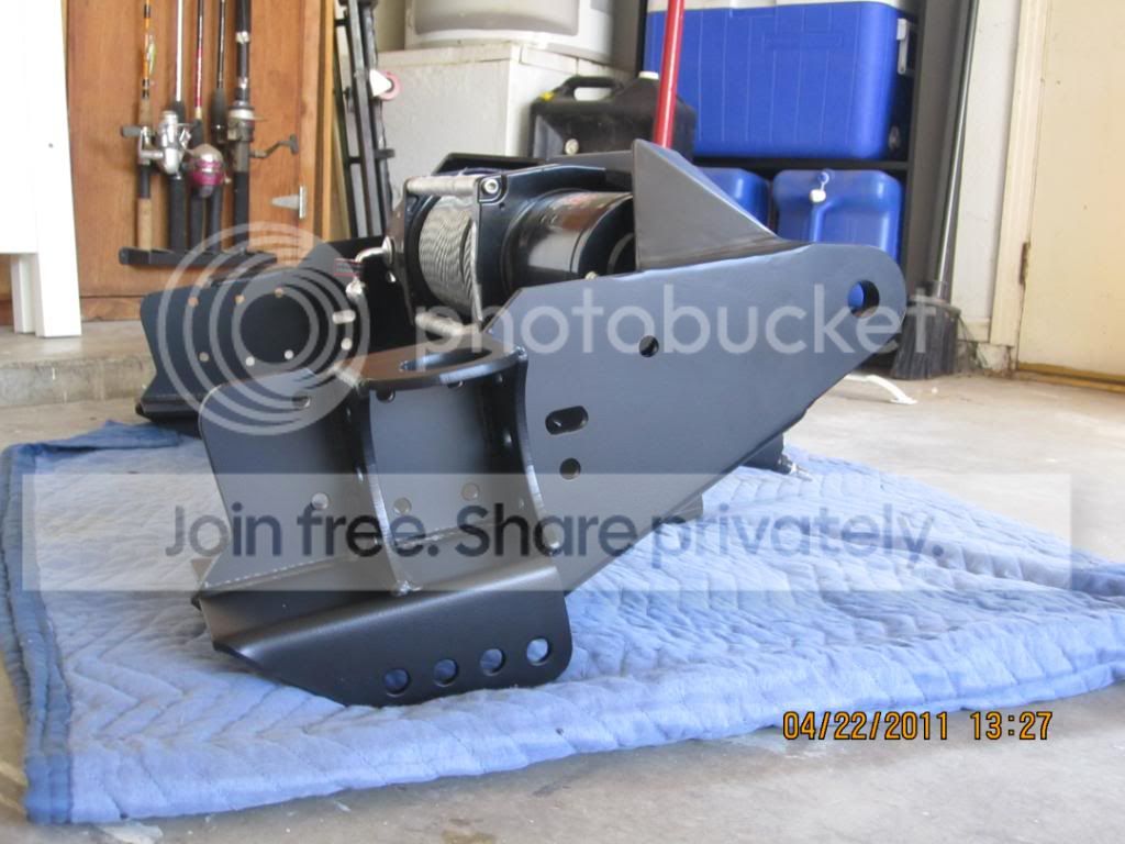

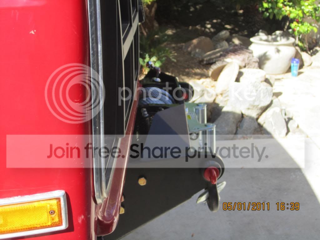

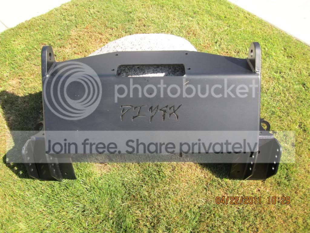

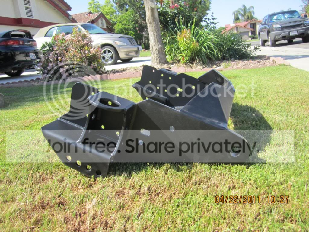

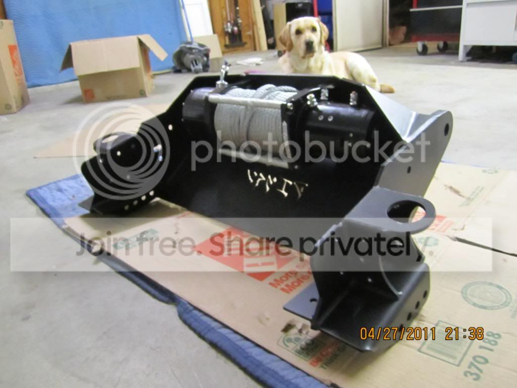

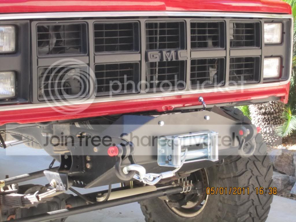

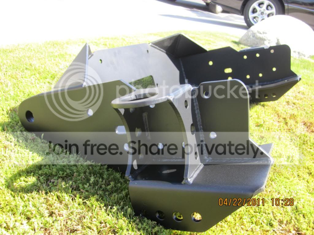

I figured I should post some pics of the bumper center.
Keep in mind, I have a 2" body lift. If you dont have a body lift, Be prepared to do some cutting. With my body lift, It fits snug and tight to the body. I love it. Diy4x hit a home run with this!!!! The winch is a XRC 12K.
Awesome Pics munepit. Your's show off the Abomb much better than anything I have taken.
