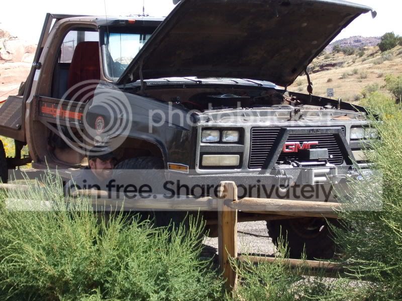

this is my first bumper i made.. not done yet. i got the c channel steel from my dads shop for free. he had them for 20 yrs and its never been used so i finally used it. so far it looks good for me.
the bumper is not completely c-channel. I made the winch plate out of c- channel and where the bumper meets the frame is c channel. It fit perfectly over the width of the frame. Excellent start to the bumper.
The rest of the bumper is made of 2x6x1/4 in thick tubing. Redneck looking but very heavy duty. I plan on redoing it and pushing the winch plate back into the grill to increase approach angle.
