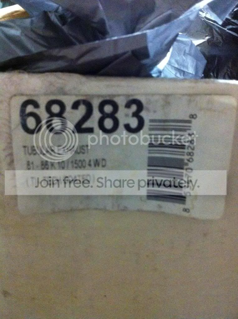

1) Find a set of Edelbrock TES shorty headers and mount them up. This is what I am running, but I was able to get them through Summit back in 2010. It seems not even Ebay has them now. You might Google it and see if anyone has overstock. Well worth the search in money saved. The headers aren't the best though. I had to kinda the passenger side collector as they don't weld it all the way around and leaks. They also use an "Edelbrock only" crush donut on the driver side.

I use the same Edelbrock TES system as K85Octane on my '86 K5 because it retains all 3 of the components I needed to pass a visual. The kit I used was for a '81-'88 K10 (#68283) and it fit like a glove + I like that I didn't have to modify the A/C bracket although I had to weld/bend a new connector pipe from the Y to the catalytic. You might still be able to find that particular kit but as K85 said, they are no longer in production. I do agree that the quality is lacking on these headers. I already have rust forming on the joints.

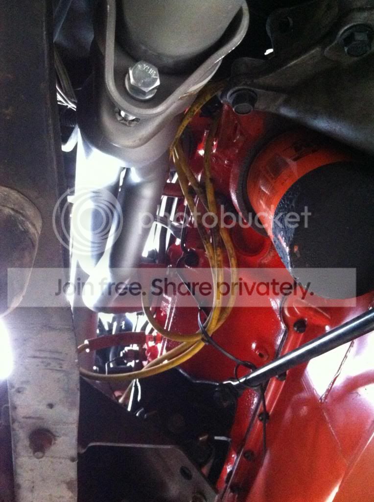

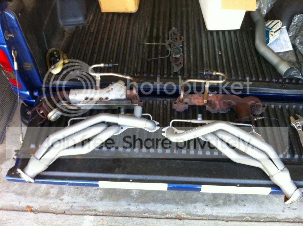

Right now I just finished installing the Doug Thorley's on my 87 K5. Mine do have the AIR setup, but its got 4 air inlets per exhaust exit on each side vs the single on the stock manifolds I had. These do have the CARB EO number and all I had to do was source the AIR tubes for both sides, new check valves and replumb. Install was a real PIA, had to move all the AC brackets etc...and also had to do some cut and welding. But now that they are on, they fit beautifully, and it all looks stock, well it is stock...nothing was changed SMOG wise, still have the o2 etc. The only difference I see is that the o2 sensor on the Doug Thorley TriY is tapped into the #7 exhaust tube, and thus get's AIR mixed into the exhaust gasses from #3 and #7 ports...vs stock which mixes with all of them on drivers side before the sensor. I don't think this will be an issue, but if it is, I can move the o2 bung to the collector. With the new style cat I think the efficiency is much greater than the old one, which required the AIR injection in the first place. I doubt the new one needs AIR to pass SMOG, but it may have to be there for o2 to adjust mixture. ANyways I'm also running a new style cat (had my old system stolen) which is why I have to replace it all. All that is left is getting a crossover pipe fabbed from both headers to the cat and I should be good to go. Planning on having the muffler shop just cross under the front drive shaft (with clearance) to the other side before it enters the cat to my single Flowmaster exhaust. If anyone wants pics I can take some.
Pics added.
1. Stock manifold with AIR
2. Driver side Cut A/C bracket to fit w/welded support on top
3. Pass side with new plumbing (literally) fixtures
4. Driver side #EO Plate
5. Underside clearance - THe DT's have plenty of room around the shackles (IMO designed really well)
