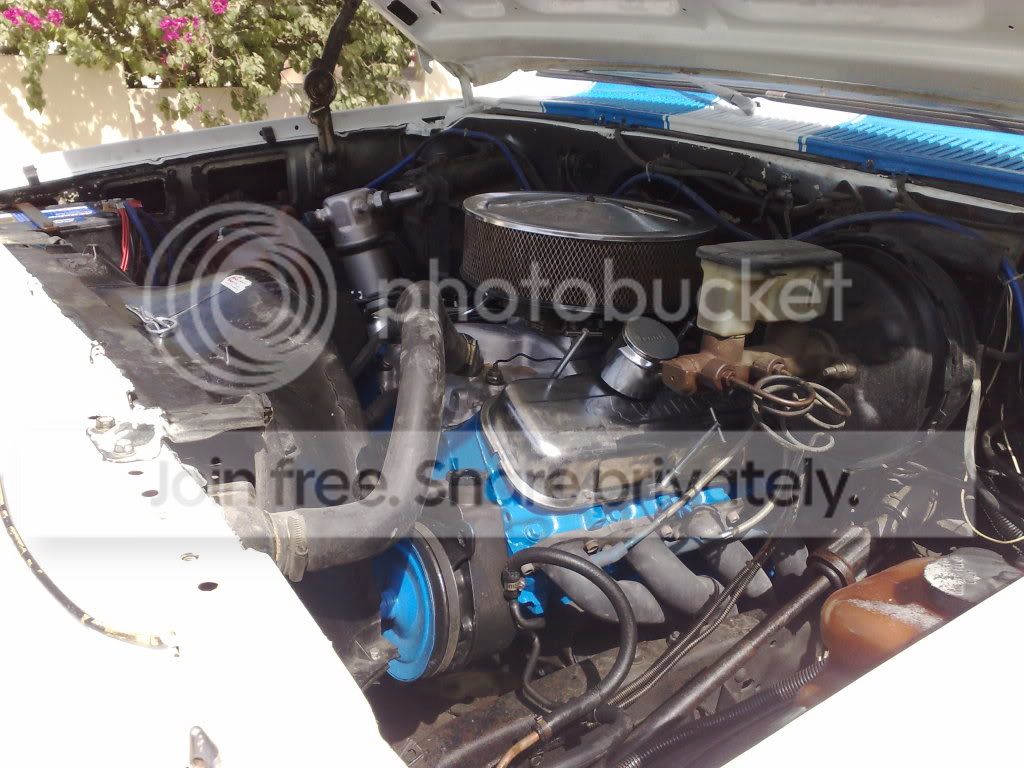

Hey brandon , ive just finished putting a set of 088,s on my big block , they are fantastic !! There is alot of big block gurus hew believe that rectangle port heads dont belong on a big block thats in a heavy blazer , i can safely say that i am running a 454 , holley 750 double pumper , 270 comp cam 4x4 extreme energy cam , 088 heads with matching intake , holley fuel pump and big headers. My motor was at the stock 230 hp mark now i believe its in the low 400s now . the accelaration mid and top end are drastically changed when i put the cam and heads on !! Im like you i very rarely take it of road , its more of a OH my god how does something that big and heavy go so fast its just wrong !! kinda type deal LOL. Go for the 088 you wont be disapointed !

What brand of headers are those? I like the thick flange at the head end.
