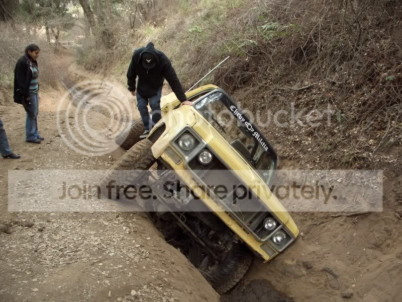

And I've searched and searched but cant find the page with the qjet mod with the tube running from front to back to help it run off camber. Linky? I figured out last time wheelin my truck doesnt like running almost on its side :doah:. Wanna help it out a little with the mod

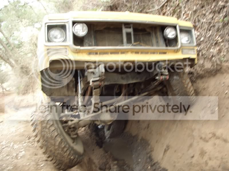

Pics:
Before:
After (ran like that for a little then would start for a few seconds then wouldnt start at all):

I still run a Q-jet and have had my truck on its side and it still ran. I haven't made any mods to it to make it work better offroad (since it works so damn good from the factory :D). I would make sure that everything is set correctly on it, particularly float level and fuel pressure (I run 2.5-3 psi)
