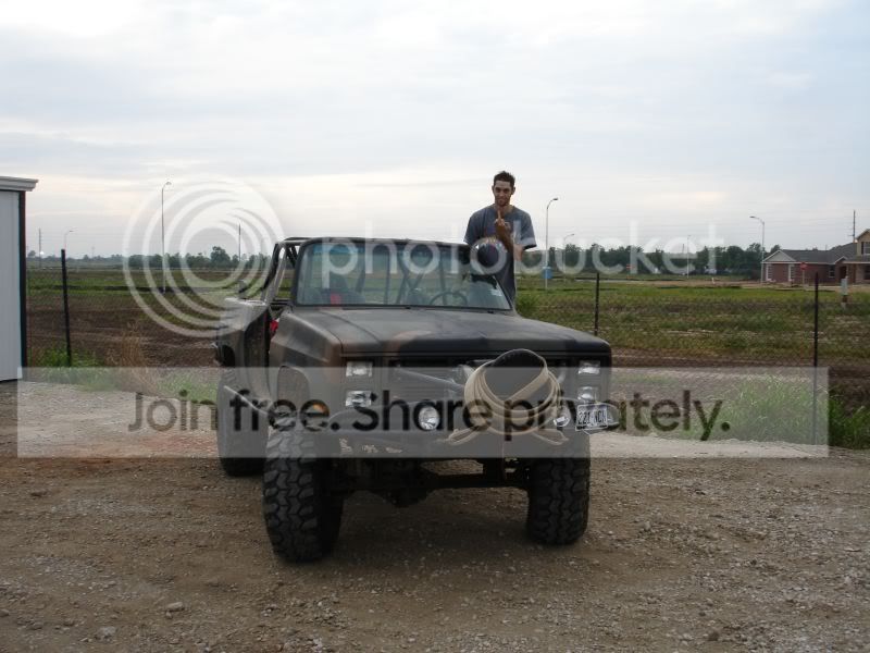

Look and perform like crap??? I have to disagree with you on that based on real world experience. For looks, I guess that it just everybody's personal preference but I don't think I would say the tires on any of the rigs below "look like crap" just because they are on narrower rims.
A 12" wide rim for a 15.5" tire is way too wide, IMHO, for off-road use especially if you don't have beadlocks. I popped both front and rear beads on my 13" wide TSL's on 10" wide rims (no, they weren't 16.5s either) at 15 psi all the time, not to mention always having to clean out dirt and other crap from the bead to keep it from leaking. The guys below all run single digit air pressures and rarely, if ever, pop beads (Ford truck has never popped a bead and is 7,000 lbs., seen the Sami pop two beads but at about 3 psi and it has a V-8 so he was gettin' it, never seen the TJ pop a bead) and only have to clean out the beads 1/4 as much as I did.
35x15.50 TSL's on 15x8's.
