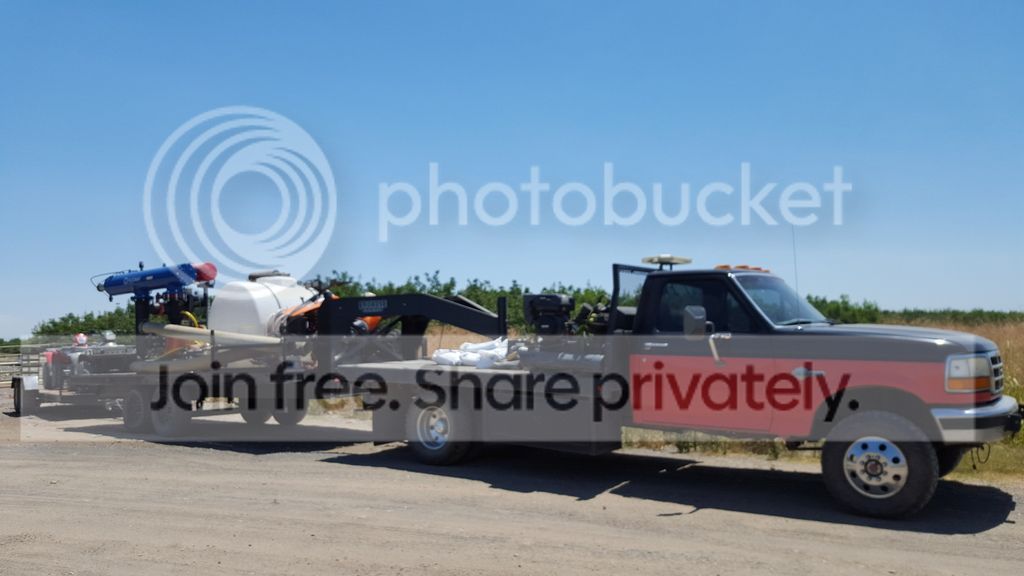

I pull doubles pretty often. First trailer must be a gooseneck, that simple. Second issue is with electric brakes is you must have both trailers brakes match voltage. Meaning, some trailer brakes come on REALLY strong at just 3.5volts. 3500lb 10" brakes are common for that. Bigger 12" brakes found on 5200-7K axles can sometimes like a little more voltage. This creates un even braking between the semi and pull trailer. I do it but I'm in ag and am running short trips so it's no big deal.
In a nutshell, pulling doubles is not a good idea for the inexperienced and especially without the right equipment, dialed in properly. Just get a long gooseneck trailer and haul both vehicles on it. You don't need tandem duals either, those 2 small cars plus the trailer is only like 14K worth of weight.
Here is my typical doubles set up.
