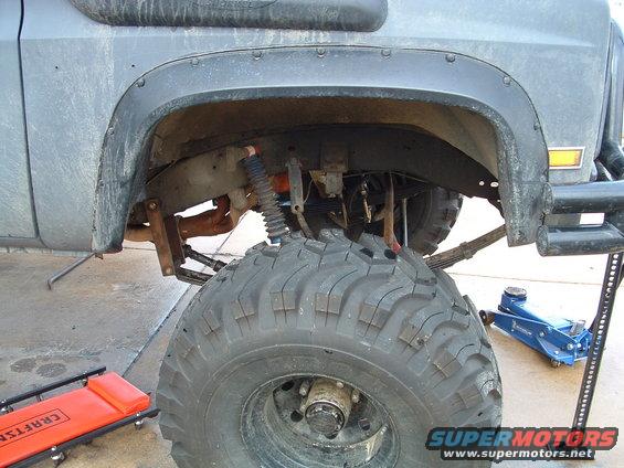

Answered your pm but will answer here also. I flipped the brackets from side to side. Here is a pic of the shackle angle:
