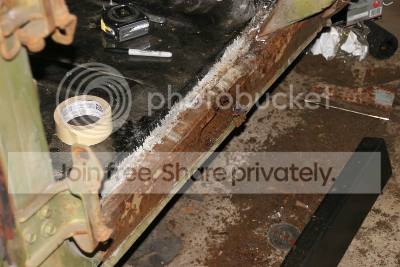

Stock set up, floor all cleaned up, X marks the spot that needed replacing:
Driver's rocker panel cut out - you can see that there's about 3" of rot packed into the rocker box that hadn't been cut out yet in that image:

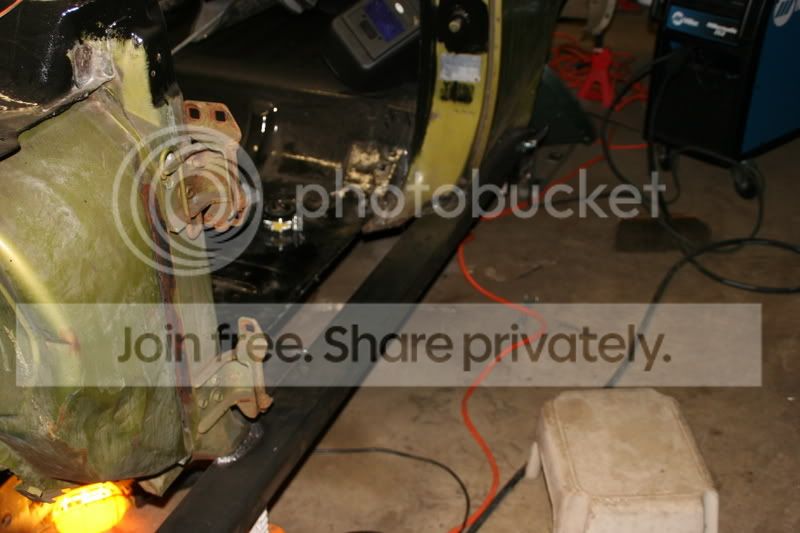

New slider tacked into place, provides the rigidity the Blazer body needs, while providing some armor:
Since I cut my body up high enough that unmodified doors wouldn't fit, and thereby there would be no way to seal out the elements, I built some door kicker panels. You can see that this gets rid of that little valley that you are saying is rusted out on your body:

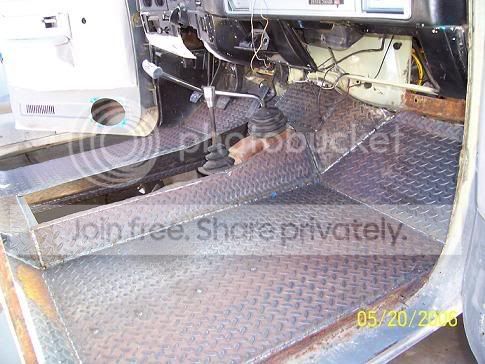

With my truck i did it backwards, i did the floor first. Now I need to do the rockers still. I have some 3/16 plate and I'll make my own tube. Hopefully the finished product will come out something like colby's. Meanwhile here is the floor.
That diamond plate floor is FN sweet!
