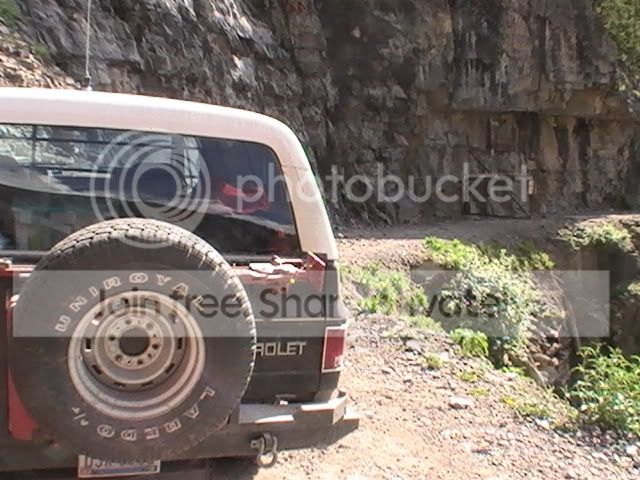

This is before I built my spare tire carrier. The base plate is still the same.
