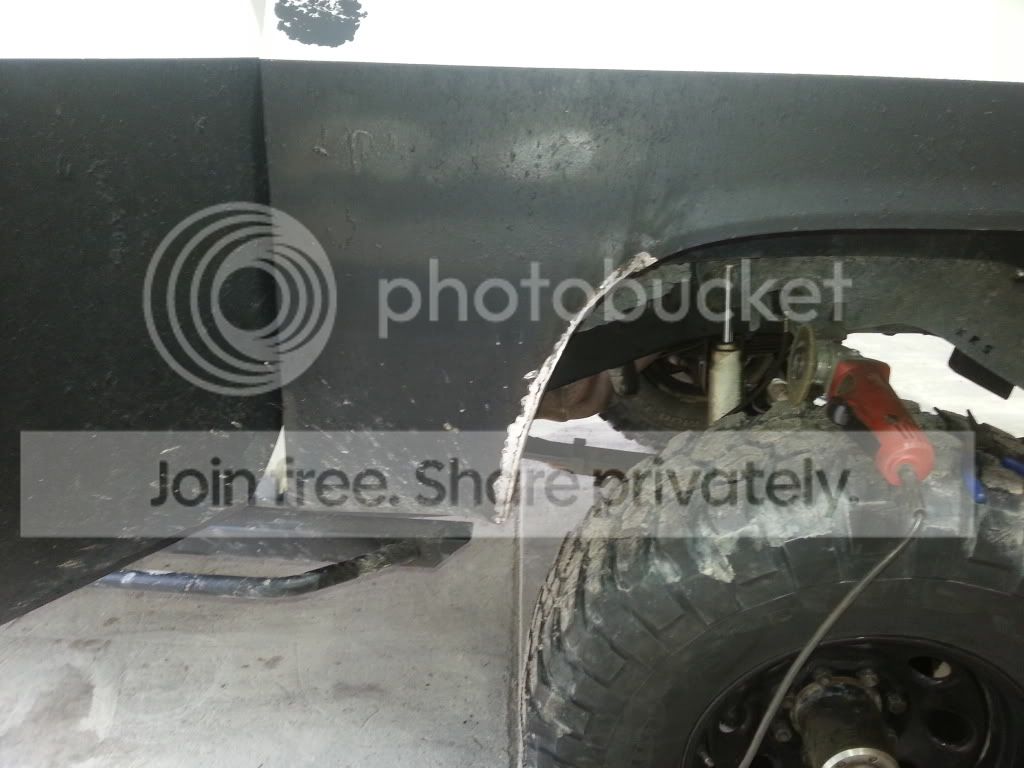

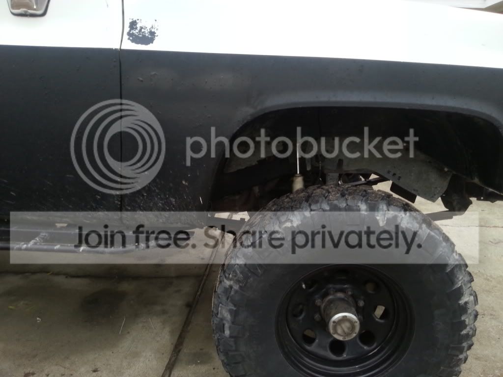

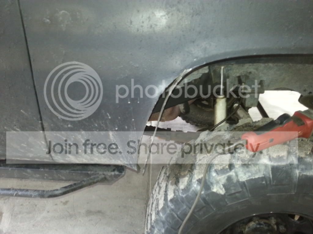

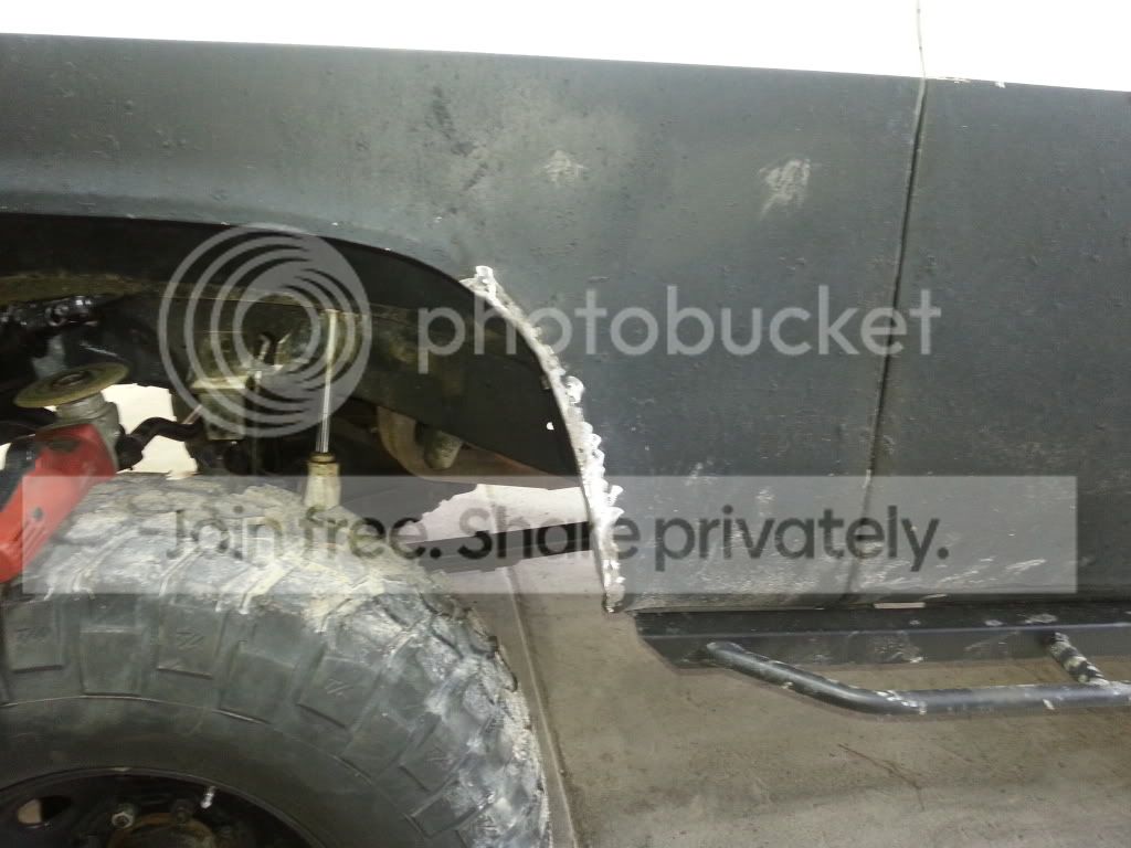

Heres a couple of pics of mine.
In this pic, if you look close you can see the cut line on the rear opening. The outer lip is cut free but the inner well is still holding it in place. (Disregard the rear axle position - 5" back - I've since changed it)
This pic shows a mostly uncut fender, only the fang was trimmed. The axle is moved 2" forward and the tires are 42" TSL's.
This is the final look, rear axle 3" back and front axle 2" forward with 8" of total lift.
