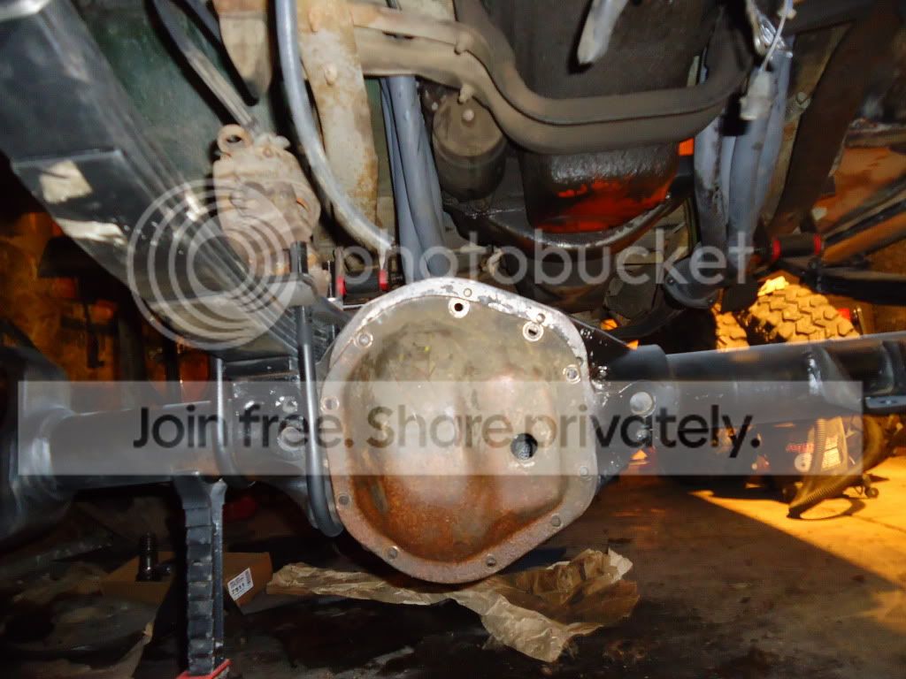

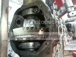

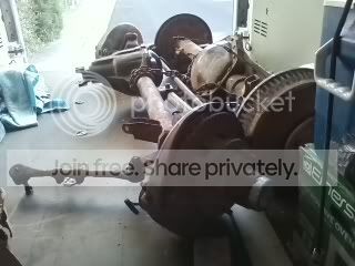

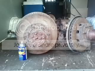

Here's a few pics from a few years back when i brought it home with the 14 bolt.
I think it looks like a D44 but none of the pictures you posted are that great for identifying one. Get a straight on shot of the diff cover.
Were the axles already out of the truck and the seller said they were '81 model year, or were they will under the truck? Considering that even a few years ago an '81 would be 25+ years it wouldn't be unusual to not be the original axle.
Don't get me wrong as if you have a D44 than great as my comments are just to verify you know what you actually have and the parts will interchange. I've just seen a lot of mis-information on whether these axles are 10-bolts or D44's over the years.
This is a Dana 44 vs 10 bolt
Your axle looks like a Dana 44 to me.
The 10 bolt is more round compared to the Dana 44. The 10 bolt front was used exclusively in 1/2 and 3/4 ton axles by 1981/82. But, it is so easy to swap them around that it was not unusual for people to swap in the older D44's if they wanted to.
