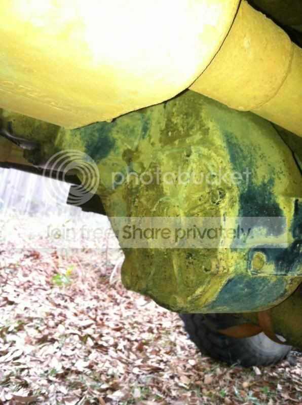

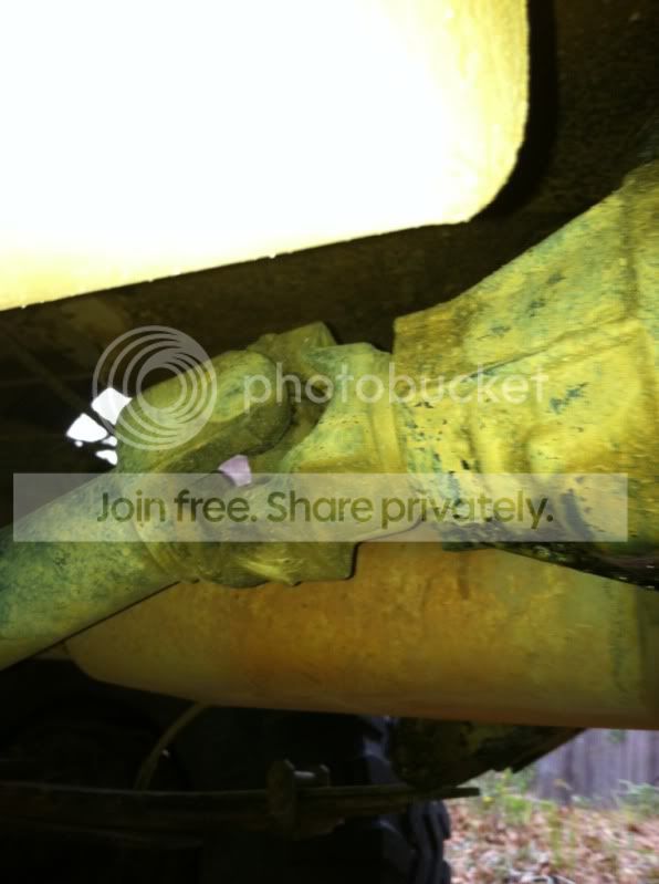

M merace19 1/2 ton status Joined Sep 19, 2003 Posts 373 Reaction score 0 Location Mobile, Alabama Feb 25, 2012 #1 Its supposedly came out of a blazer... This is the best pics I have of it. Thanks
4X4HIGH 1 ton status GMOTM Winner Joined Dec 14, 2001 Posts 22,423 Reaction score 662 Location Fremont, CA. Feb 25, 2012 #2 That is an NP203.
M merace19 1/2 ton status Joined Sep 19, 2003 Posts 373 Reaction score 0 Location Mobile, Alabama Feb 25, 2012 #3 203 would have a extra gear case would it not? I am hoping for 205... It does have a fixed yoke on the rear..

M merace19 1/2 ton status Joined Sep 19, 2003 Posts 373 Reaction score 0 Location Mobile, Alabama Feb 25, 2012 #4 yeap I been looking around and its a 203....... Welll......
4X4HIGH 1 ton status GMOTM Winner Joined Dec 14, 2001 Posts 22,423 Reaction score 662 Location Fremont, CA. Feb 25, 2012 #5 A 205 will be easy to identify by a small round plate held on with 3 bolts on the rear of the case.
M merace19 1/2 ton status Joined Sep 19, 2003 Posts 373 Reaction score 0 Location Mobile, Alabama Feb 25, 2012 #6 I just went by the fill plug. its where a 203's would be..
