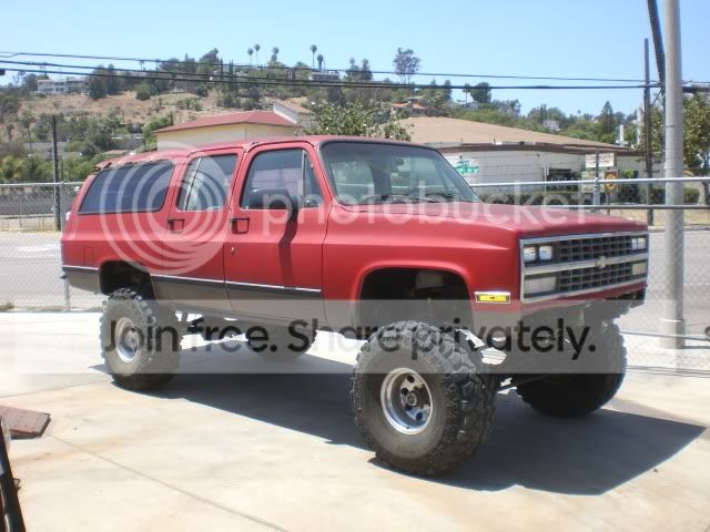

I have put a body of an FSJ on a 77 Jimmy. Kept the Jimmy engine and running gear 4" lift. Now a few years later and the Jimmy is toast and its time for a freshening up. I was basically given a lifted Burb that I will use as a Donor rig. The body will be scraped out so I will have no issues getting that off the frame in one piece. The FSJ front clip comes off very easily so that wont be an issue either. The floor in the fsj is much higher in it than the Jimmy giving all kinds of clearance between the frame and body. It looks like it should go? Just wondering if anyone has done it in a GM 4x4? If so Im sure I can do it with what I have here. Thanks for the direction.

Oh No! Its not going to waste, doors and glass is all spoken for dash insert and gauges as well as the steering column. Handles have been claimed as well as the seats, hood and front fenders. The body is a totally non fixable rust bucket. Look close at roof above the rear window and door. That is a rust hole all the way through into the interior. Besides Its not smogable. with all the mods that have been done to it.

Look at the cancer above the front door and from the front of the back window all the way to the rear.

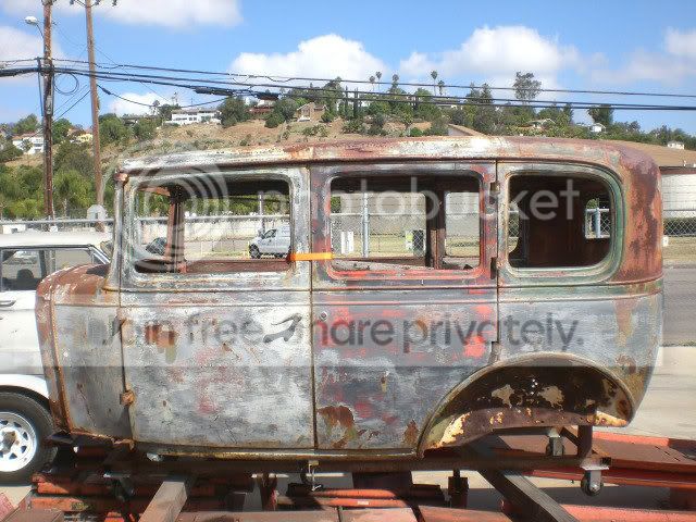

I bought this 1931 Chevrolet body last week. Local car that has been setting out since 1931. Has surface rust but no cancer at all! Of course all the wood is gone form it but the metal is in really good shape! This Burb body is Trash for this part of the world.
