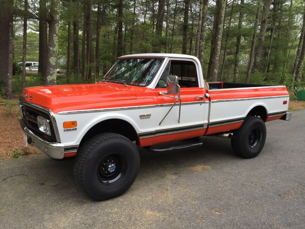

72 K20 454 700r4 205 D44 front D60 ff rear with unknown gear ratio at this time and 35s. Let's assume 3.73s (aka, not enough gear).
I could regear the axles for him. But I think he'd be overworking that D60 rear.
I could swap in a D60/14ff with 4.56s. Will the square body D60 bolt into this chassis? And I can weld rear spring perches cause I'm sure they'll need to be moved.
I could swap in a rear 14ff with 4.56 and regear the front to match.
I already told him the 700r4 is a weak point and we talked about getting a Bowtie Overdrive trans built for what he plans on doing. I also discussed smaller tires for towing.
But, solid frame, suspension, body, bed, etc... Can this truck tow a 5th wheel camper if built accordingly? I need all your collective thoughts on this. Any advice. Any recommendations.
The owner is retired military. Biker. Mason. And has a little money put away for this but not a lot coming in every month. Just wants a simple life in his camper and to be able to pull his home wherever he feels like staying (like warmer states in the winter).

Also need to find out of the truck is too tall for the trailer before you worry about pulling it.
That's truck doesn't look too tall. But you never know.
It'd probably pull a 24-26' bumper pull trailer just fine...
The rear is plenty strong for into the 10-12k range. With 35s a fifth wheel is up there pretty high. Gearing would be fine if he went back to stockish size tires and springs. Then the fifth wheel will sit at a better height as well. It's a nice gmc. I wouldn't want to part with it either. But for long distance driving it's not really the best choice. But as long as everything is gone through and checks out I wouldn't worry too much about driving it. Just one guys opinion.

The truck was an impulse buy. He wanted something old, specifically. He has reasoned this to me using the "end of the world" scenario (I don't argue with this dude, just smile n nod :D). "An EMP will wipe out a newer car, I can get this trick back up n running by just replacing a coil n battery" I didn't want to mention Mythbusters blowing that theory out of the water, as an EMP will just confuse a modern car for a minute, then it's fine. So, this is what I have to work with :rolleyes:.
I haven't asked but I'm pretty sure the camper was an impulse buy too. He hates his apartment, wanted a place to stay in that was seperate from anyone else and could be moved if needed. The "traveling to warmer states" was an after thought just brought up this week after I got the truck running an all 8 cylinders instead of 6.5-7. In case you're wondering, 1 plug completely fouled out and one way over gapped to the point I'm sure it was missing under load. New cap, rotor, wires, plugs had it sorted out.
