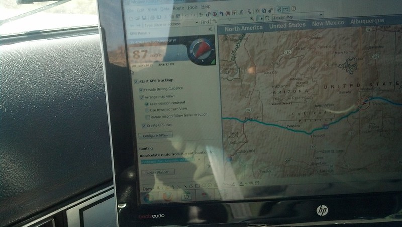

Here we were flying 87 MPH on I40 in the K10 on the AZ/NM border the year we cruised out to Death Valley
