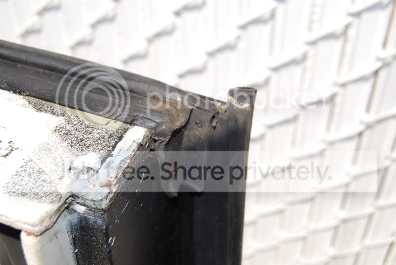

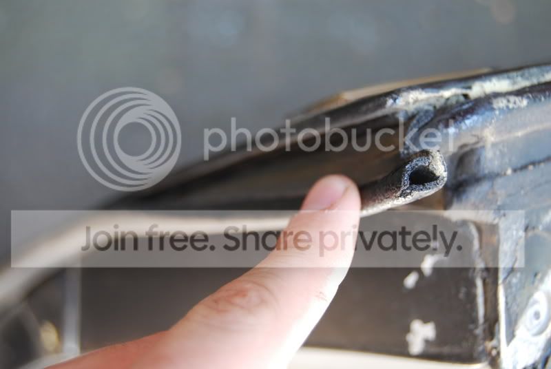

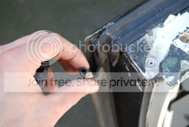

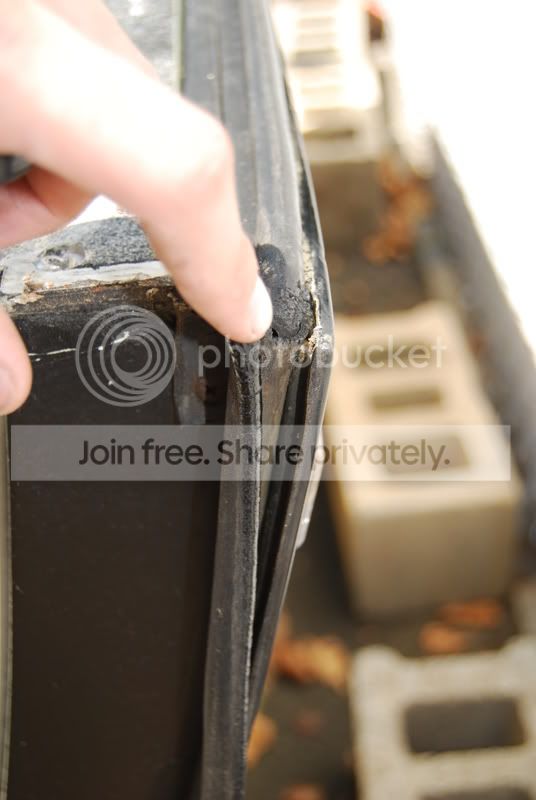

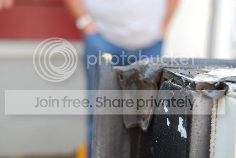

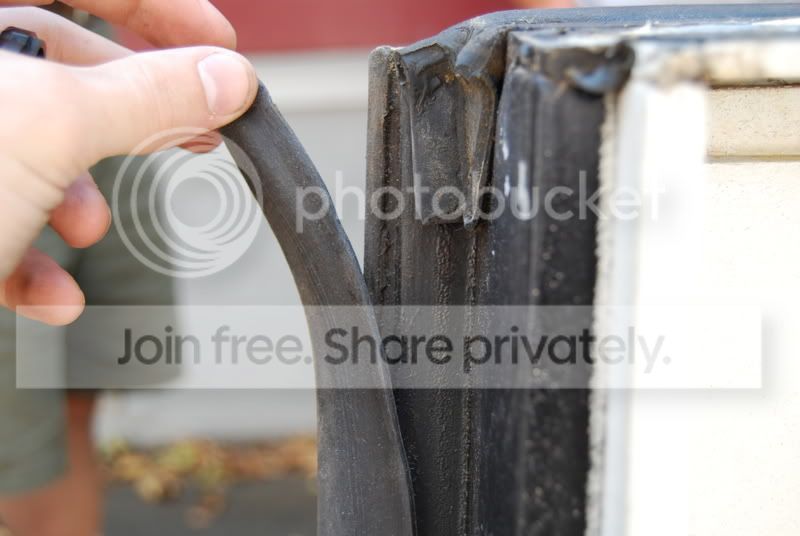

Ok, my cap is leaking slightly from the corners where the horizontal part of the cap and the vertical part of the cap meet at the 90 degree angle by the doors.
The Horizontal piece of WS looks like it is curving up before it gets to the very corner where it looks like its leaking, and the vertical pieces come straight down, behind the horizontal piece, but there is a gap between them, what is wrong, and how can I fix it?
Will post pictures of it momentarily, just have to get the cap flpped over to take pictures, lol. Heavy and akward sucker.
new ws may be the answer...those things tend to dry rot...try lmctruck.com and you should be able to get replacement ws

IIRC, and as your pictures show, the weatherstripping on the cap is screwed at either end, so no, nothing on the bedrail. At least not on the "half" removable tops, as opposed to the earlier K5's with the entire roof that comes off, which I have no idea how they were sealed on the bedrail. Probably the same way.
