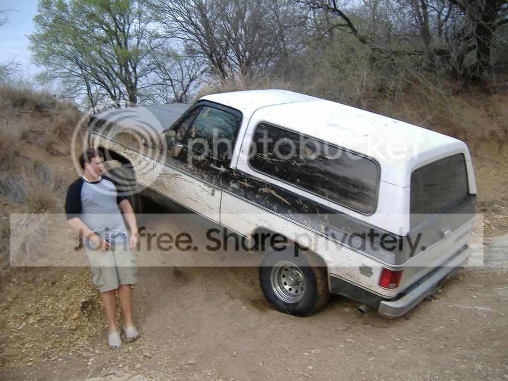

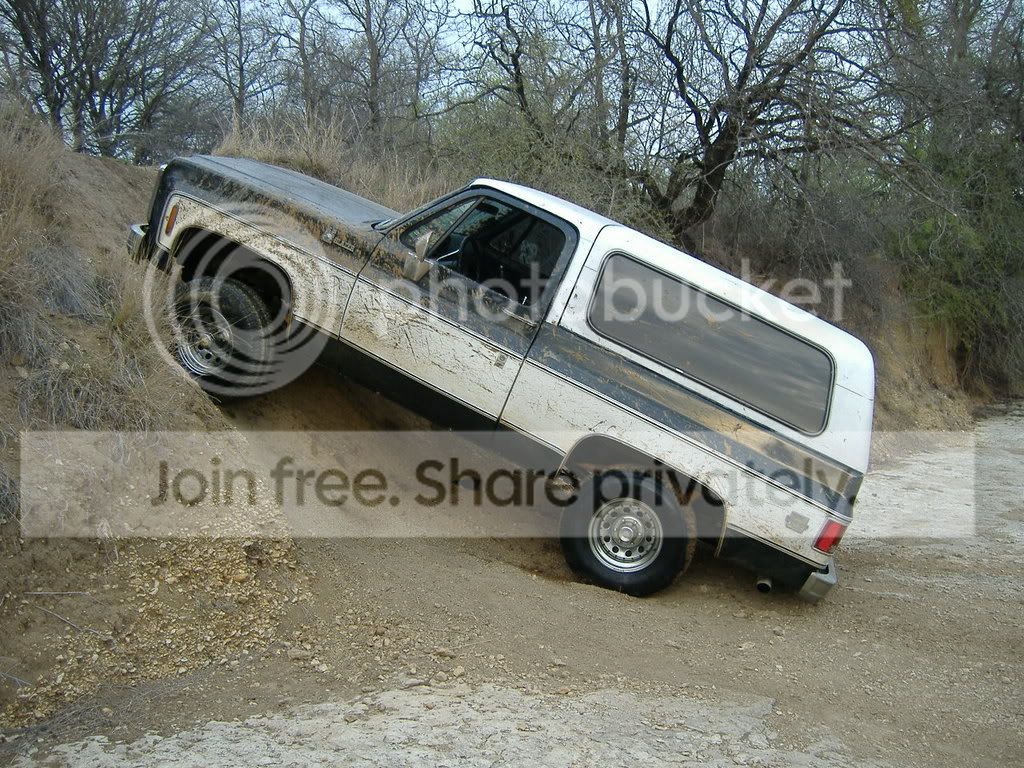

Is there anyway around this? Would a better newer carburetor work better or do I just have to switch to TBI
my engine cuts out alot on inclines and now its causing me to get stuck
I'm 6'1 so that was probably to steep anyways but it does it on other hills aswell
Opinions?
