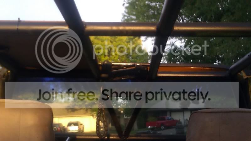

My CB mount
I attached mine to the tranny hump right in front of the 4WD shifter. The mic mounts to my dash next to the vent.
I didn't use any fancy wire nuts, I just use the cigarette lighter attachment. the plug is in the ashtray.
My antenna is mounted on my rear bumper.
Where's yours mounted?
