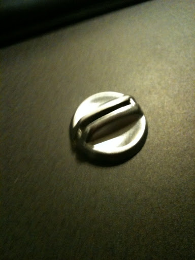

Ok, so i broke the knob off my center console, and can't find a replacement. Mine is chrome and looks like this:
Currently, i found this one, but dont' think it will work:
getimage.php
Thats all rock auto had. As well as Kragen. Couldn't find anythign at LMC.
My interior is very stock, and in very good shape, and the lack of knob, and sharp thing i have to turn to get in teh console is making my truck feel like a POS.
What say you guys? How do i get the old cylinder out? From there, Where can i source the correct new one?

Ok, so my dealer didn't have it, and idnt' know when he could get it, so he put me in touch with dealers that had it in stock. The part number for the cylinder/knob only is 12507449
Ordered it from a dealer back east.
I will verify its the right part when i receive it.
Negative on blazerfest. I'll let you know when i get the part

um, SUCK. hopefully i can figure it out. That locksmith must be a tard, i remember taking it apart accidentally when i was like 5 on our first burb. And putting it back together no problem :haha:
Ok, so i got the new cylinder. Finally got it out, rekeyed the new one to match the old, installed. Can't figure out how to properly engage/load the return spring. Right now, it won't latch unless i turn the knob manually.
Anyone?
Ok, got it all back together, AND it locks!
Scary part is it probably took me the better part of 3 hours to get it done.
Wish i had good pics/tips to post, but dont' really. If you need help, let me know.
