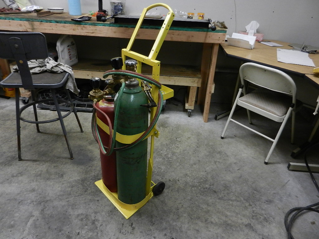

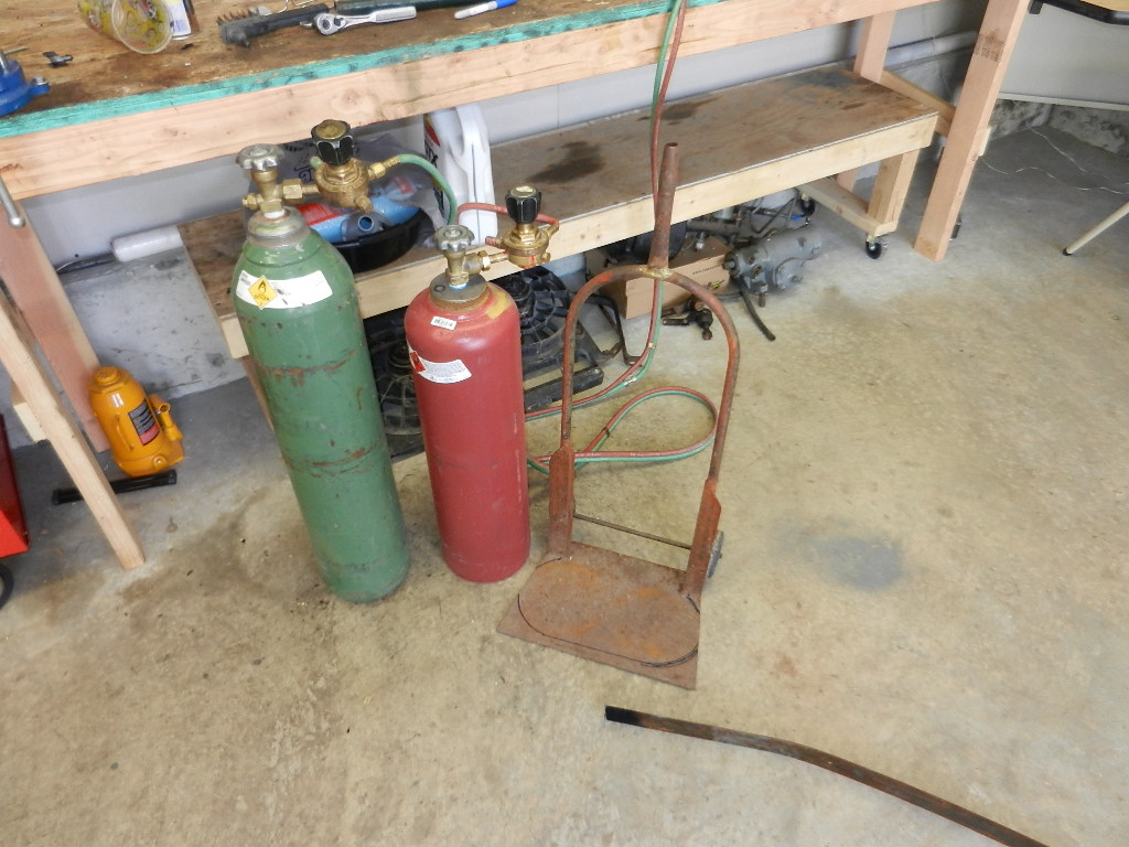

finally got the chance to try and build something. decided to build my torch cart before doing the welding cart since I had a little hand truck to use as a starting point.

Good work now run to harbor freight and pick some of these up
these work great for my oxy/acy setup
yeah, the wheels I have on there are a little small. next time I'm at HF I'll be looking at some bigger wheels.
