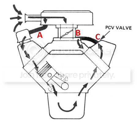

http://s1229.photobucket.com/user/edostar/media/pcv_valve-scaled500-1.jpg.html
You can use a vented oil filler cap for a breather,but if the oil filler is on the same valve cover as the PVC is,it wont work right--it has to be set up as indicated in the illustration above...

You should get another set of valve covers, which come with some kind of breather holes on both sides. Summit or Jegs have some cheap in-house brands. I have had several sets of these cheap in-house brand chinese covers, and they worked just fine. Then hook them up like shown in the above diagram. Use vacuum adapters to adapt the lines to proper size needed.
