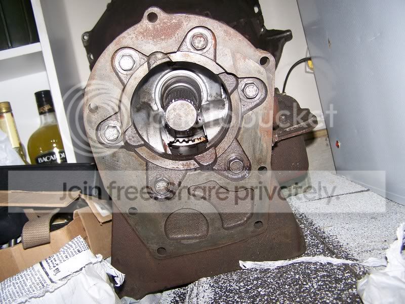

heres what I've got, looks like it's the round style with a short output, so I think that I need a whole new tranny and t-case or??
is there such a thing as a long output and a short output cuz what I've got doesn't look like it would be long enough to make it through one of those np205 adapters
info for ya.
th350 has 1 tail shaft for 203 and 205. same length.
th400 has a few diffrent. 203 has your stubby one. then 205 has i think 2 diffrent ones as to the vintage of the 205 32 spline input length.
i have a complete minus shifter 32 spline 205 with fig 8 style adaptor for sale. plus shipping and thay are heavy items. flat flange frt and fixed rear from a 1ton truck.
i have the frame braces also or a brace rod to bellhousing also.
and a few hd ears for 1/2 and 3/4 ton crossmembers only as 1 ton is diffrent.
pm me if you want to work out a deal.

hi jack will a 205 for a 400 bolt up in place of a 208 if you change the adapter and all???
ummm.. so the 205 I have is from an 1987 one ton with an sm465.. I THINK that means it's a 32 spline?? does that mean that all I'd need is the 400/205 adapter and a new output shaft for my 400??

That 205 is the same as the 400 version of the same year. Not sure about the output on the 400 though.
