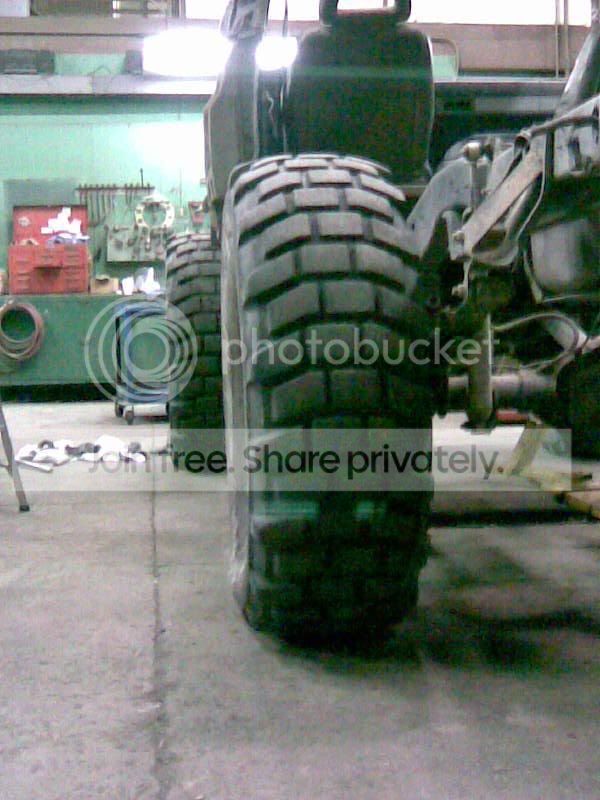

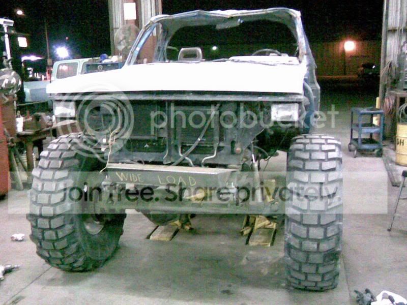

I run DRW hubs on my blazer because I have 44" tires and they hit the steering box if I don't have the DRW hubs on it to space them out. The front is a lot wider than the back but my blazer is an offroad only truggy. See how you can see the steering knuckle, etc. since I have SRW wheels on DRW hubs? I think it's like 3-4" wider per side.
