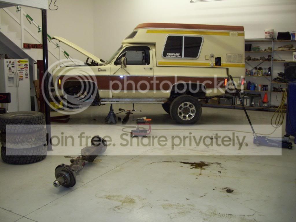

Dave...right on...i'd rather learn it myself and tune myself than pay top dollar for someone else to do it.
Currently in the middle of this swap...last thing to do before i move to phx....
Once i get there and settle in i'll need to order the emulator from moates and log some data....good thing i modified my puter stand from the 06 dmax to fit the 79 K5.
