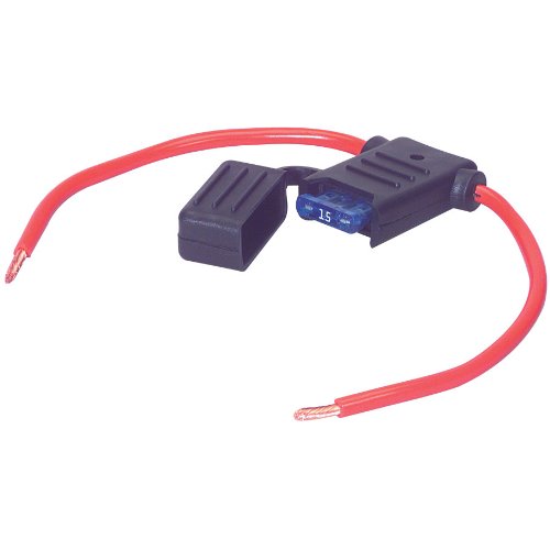

I'm looking for an inline circuit breaker, similar to this inline fuse holder (the two wires are all I need). But, I'm having a helluva time finding one. All I can seem to find are ones that are either audio related (too expensive) or have additional wires like this one.
Are there any simple, and inexpensive, inline circuit breaker holders/relays on the market?

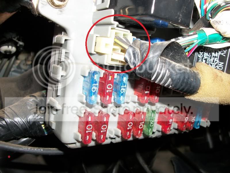

Here's why I need it: the overdrive wire from my 700R4 is plugged directly into an ignition hot in the fuse box beneath the dash. With all the rattling my truck does, the wire wiggles around, causing the tranny to go in and out of OD. Which is bad. I've been driving without OD, but I'd like to get it back. The circuit breaker is part of the solution. The second part is finding an adapter that will plug into the ignition hot in the fuse box. Check out the pics for what I mean.
This is where the wire is currently plugged in:

I can't see the pic (edit: I can't see the first pic...second pic tells me nothing)...is it one of the auxillary ports on the stock panel that the connector locks in place? I can't see those wiggling out, it's how I ran my injection for years.

Here's another copy of the first pic. It's a bit large, which is why I used the other one, but this will have to do so that you can all see it. Currently, OD is plugged into the IGN on the top left. So, I'm looking for a plastic piece that I can run wire to, and that will click into the IGN so that no wiggling of the wire will occur.

Do you see IGN in the top left corner? I'm looking for a connector to clip into that similar to the brown connector you pointed out on the top right of the pic?
Every GM vehicle that used those style fuses AFAIK had those connectors. Cars, trucks, anything from about 1981-1994 or even later.
You are circling the wrong things. Those are unused fuse slots. The "IGN" arrow is pointing to the correct slot. The two at the bottom middle with "BAT" are the same thing, but obviously battery voltage.
Again, the connectors are keyed, so you'll need the right one, but they will be very easy to find. Just make a drawing of the shape you need, or grab one of each in the yard.
And while I don't think they are very good, they (the aftermarket) ALSO make fuses with a pigtail hanging off of them, so you can tap off of that. But IMO not a good idea to overload the fused circuit, and if the fuse did pop, you are out the money for another one. Not like you normally lose fuses, but we make mistakes wiring sometimes. :)
You need the Delphi Pack con terminals. It is either pack con 1 or pack con 3. I think American Auto wire may have a kit for what you are looking to do. I look later and may find the kit.
