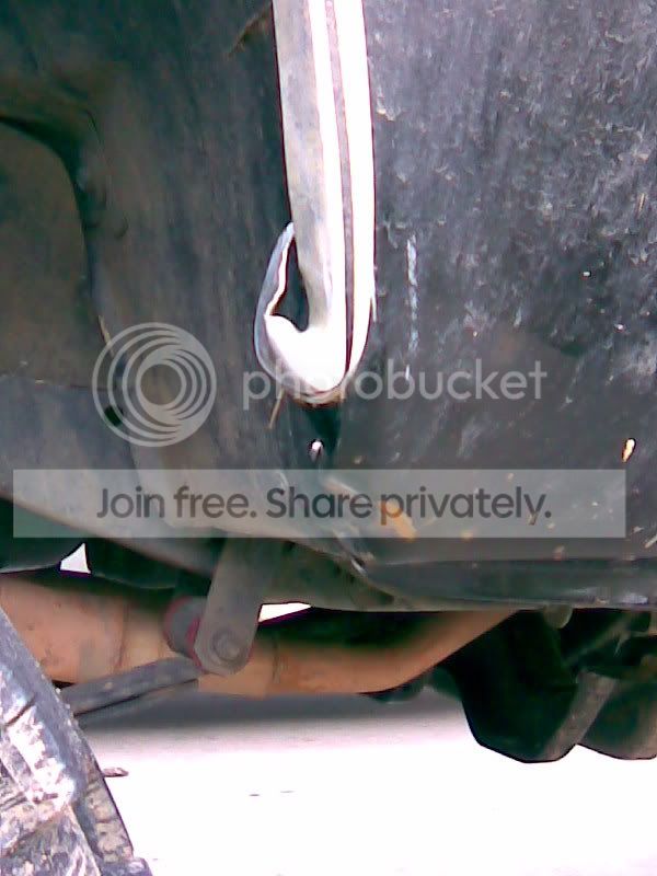

Ok if it wasnt for CK5 my blazer would still be stock and really pretty:D. But since I've found this site, being stock and keeping it on the street just isnt cool. Well so I started taking it offroad and putting small scraths in the paint from driving through the woods, but I wanted to fit in. So I needed more. Well so I got a lift 6" lift kit and of course you need bigger tires to go with it. So I pull all my saving for my new truck to get it so I would be one of the guys or so I though. Cant be one of the guys when your on the street and everyone else is not:(. Well I went wheeling this weekend and suffered my first really body damage. Since Im running 6" lift with 36" tires and no fender trimming I finally smashed up the corner of my fender:(. Well since I blame yall for the damage, becuase yall peer presured me into modifying my truck. I will leave this up to yall. Fix the damaged fender or break out the cut off wheel?

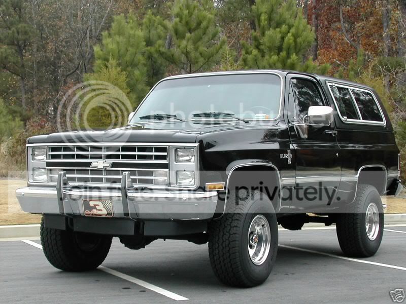

when I first got her (so inocent)

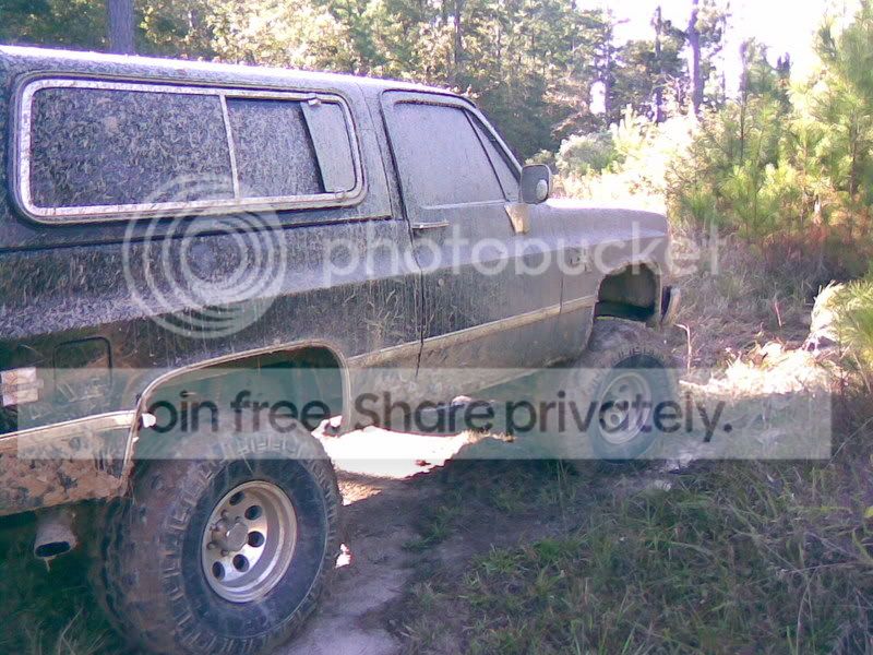

took her on some trails (but was limited on what I could do)

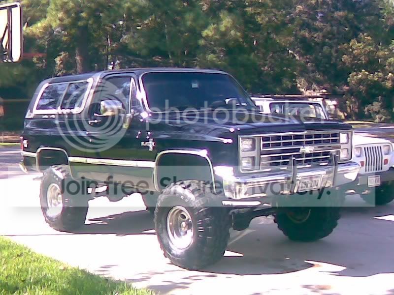

Then the lift came

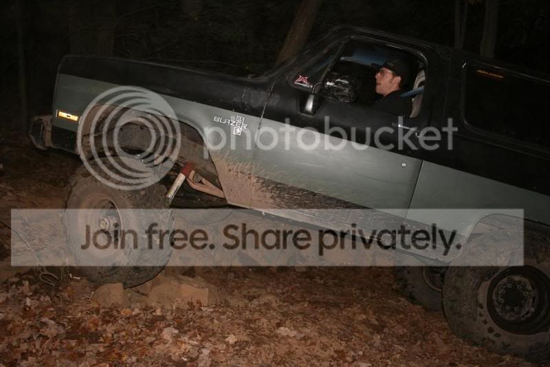

Then the offroading
And now the damage

you got a nice nice truck, I'd go ahead and take the money away from something else and fix it, then trim it some so maybe it won't happen, or happen as bad. That is a sweet sweet lookin k5
That's some pretty insignificant damage IMO, cut the fenders so it won't happen again. You can cut it and still have it look good, there have even been a few people who kept the stock trim.

I run a 4in lift and 36 tsl's and I just cut my fenders. Your best bet is to cut the lip of the out fender flush to the fire wall and get a zero rate to move the axle forward. You wont rub for sh1t then.

I cut the corners off the front fenders where tires usually rub. Then rolled the metal over and put the chrome trim back on. You cant even tell I cut them.

That is proble what I will end up doing. I want to just replace the fender but I know it will just end up happing again. So I guess the cut off wheel will be coming out next week.

If you trim and follow the body line, it will still look decent. Just go back a half inch.
WOW you call that damage, just wait it gets worse. I think you need to break out that cutting wheel.
