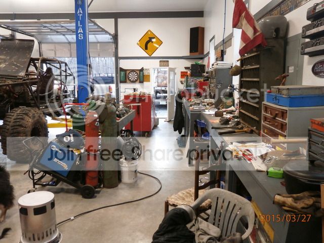

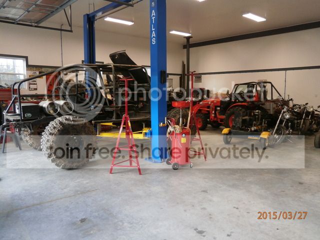

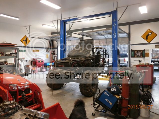

18x40x12, way to small for a fab shop. Plan on moving in a few years and building a 60x100x16

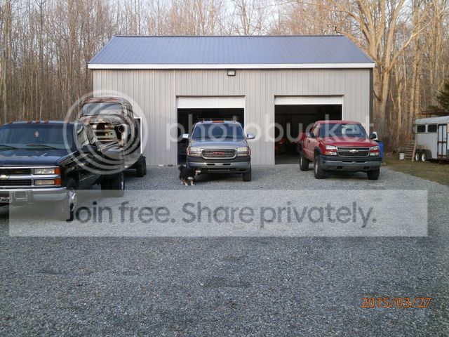

40' X 40' X 14'.......Should have went 50' deep.:doah: Future mods will be a enclosed lean-two on one or both sides.
I am only running the 2 car set up right now...
Someday there will be a larger property supporting my habit.
