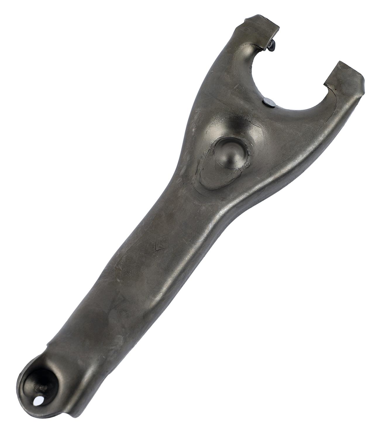

Okay can someone tell me where this spring is supposed to mount other than the exhaust pipe?

Your clutch fork is a broken welded up piece of crap. The end is broken off your clutch fork and steel tabs have been welded to it as a spring hook and adjustment rod pad. If you look at your clutch pedal lever you see a small hole that one end of the spring is supposed to attach too. Then the other side of the spring is supposed to attach to the clutch fork mounting hole, thus pulling the clutch pedal lever and fork together. You need to buy a new clutch fork, in order to straighten out your mess of a clutch assembly.

That rigged up clutch fork is going to leave his truck broke down somewhere one day. Best to bite the bullet, and yank the trans out to install a new clutch fork. Going hydraulic would be nice, but for a dependable fix that will not break the bank or take design modification time a new mechanical clutch fork will make the truck dependable...at least in the clutch department.

I am failing to see the broken part of it. The screw holding the end of the spring isn't how the factory did it, but I wouldn't junk it because of that. Maybe make it a bolt in style pin, rather than putting the spring into the hole where the screw is.

There is a smaller spring that holds the fork to the push rod, then there is is the longer one (shown) to pull/ lift the pedal (clutch release). The one in the picture looks like it's trying to substitute for the small spring, holding tension between the fork and the rod?

Good point, my old brain forgot about the little spring. Too used to the older ones and brain fart..
Well thanks for all the input everyone. I have fixed my spring problem.
