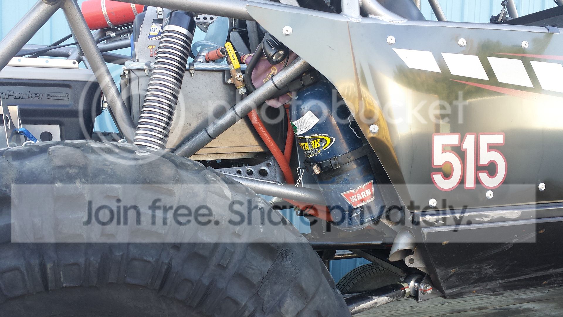

a large crown royal bag works good to cover the valve/reg to keep dirt off in the rig. I only take my regulator off to fill it. I need to build or find a different handle/protector to fit in the buggy a little better, its a puzzle to get it to fit right in the chassis.
