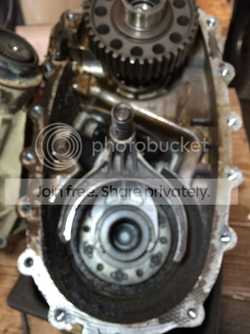

Yesterday we took out the transfer case apparently not everyone knows about GM pump rub! :eek1:
This one has been run dry for what looks like to me years!! :doah:
I don`t get it the guy we got it from spent a lot of money trying to get the trans right...but nobody bothered to check the oil in the T/C.
This one is shot, not even going to try to fix it. I has two holes in the case one from the pump and one from the snap ring at the back of the case!
Found one yesterday with 220 kms for 650 hopefully I can pic it up today.
Hole from the pump
Not very clear but you can see how dry and black it is!
This is the hole from the snap ring...never heard of this happening before! Couldn`t even get it to release from the shaft!
