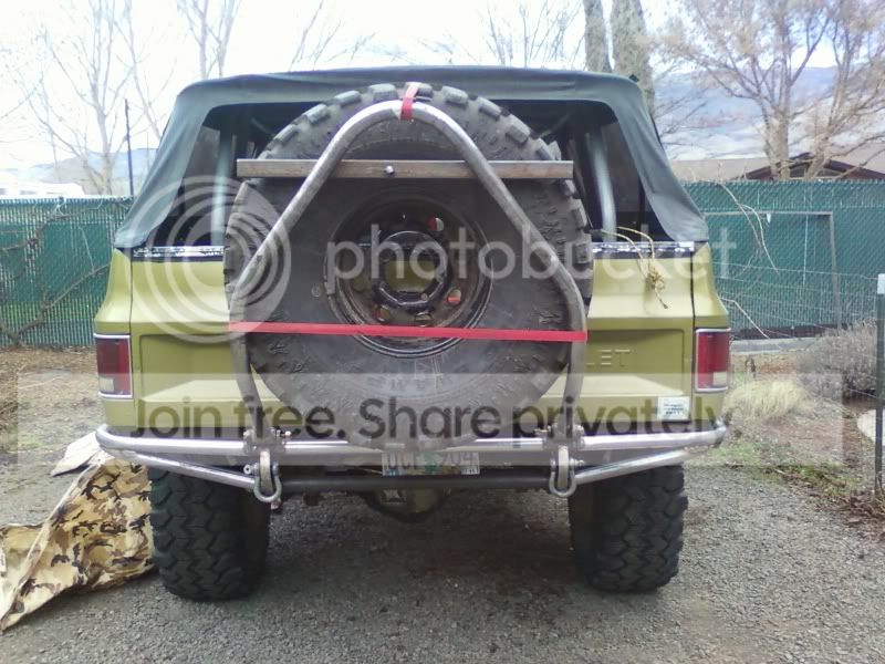

Do you plan to be able to open the tailgate still? The reason i ask is because it looks like the brackets for the tire carrier are going to be in the way. Because of the way the gate opens it hangs lower than you think when opened. If you've already accounted for this then forget what i just said. The pics could be deceiving though.
Yep, I accounted for this. The only reason it works is because I'm using a truck tailgate which has that nice indent. I have about an inch of clearance between the brackets and the gate. :)

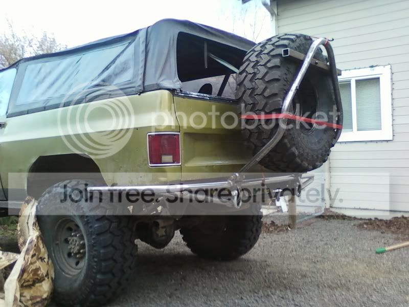

updated pic. still need to add a few more degrees of bend to the stinger to make it look clean... the 2x2 tube is a spacer that will be deleted by adding a few more degrees of bend. :)
Looks good. What are you going to do to hold the stinger up, and keep the tire off the gate?

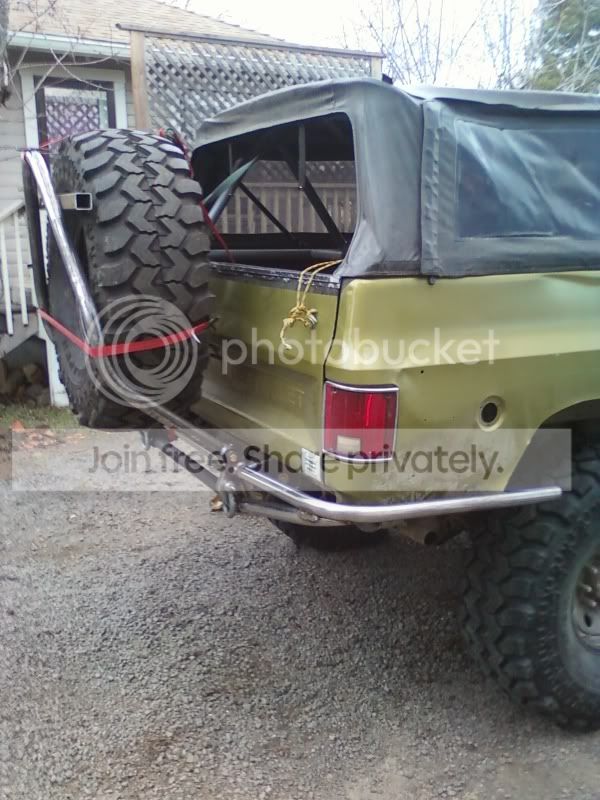

I got a couple more tubes added this afternoon. I'm really excited with the way this is turning out. Today I added the lower bars that go from the outside of the frame to the corners of the bumper. I think I just need to add 2 more tubes to the bumper part for it to be complete, plus finish welding. These two will likely connect from the cage-to-frame mounts over to the bumper near the wheel well opening to give the sides a bit more rigidity.
I have some more thinking/designing to do with regard to the tire carrier portion, though.

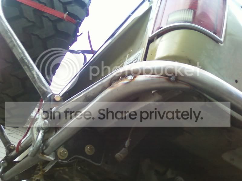

And finally, I'm really excited about this wrap-around.
It should help the rigidity of the whole side bar, and it keeps it from significantly reducing my departure angle. :)
thanks!
i used a bunch of cut off wheels, a grinding wheel and a 4.5" grinder... :D kinda a sucky process, I almost went up to the school to use the plasma because using the grinder inside the bend wasn't very fun. But, I kind of skipped out early on class to work on this - so I figured it wouldn't be good to go back at that time. :haha:

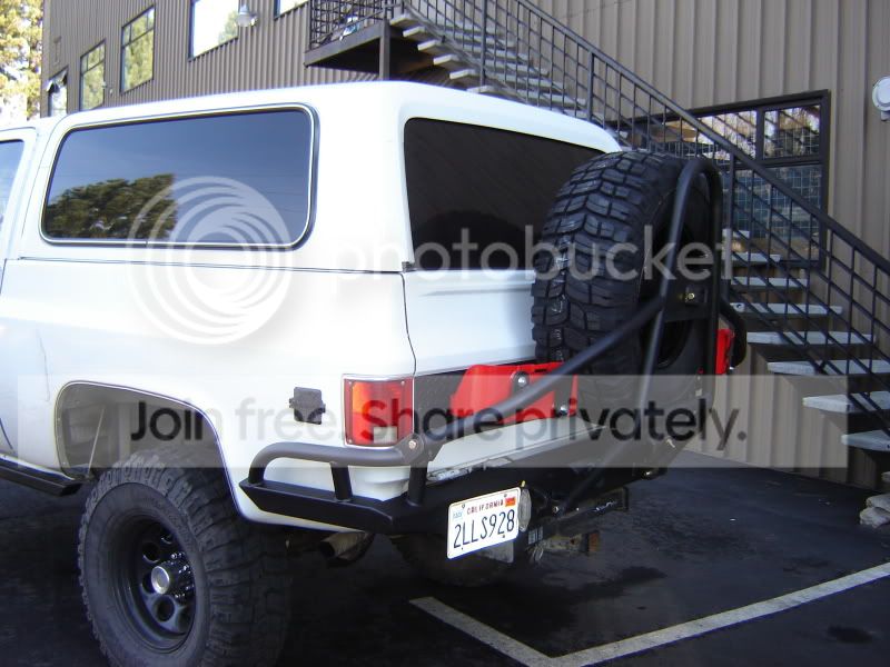

1. to mount the tire to the carrier, are you gonna put in a bolt plate like on the BOR that the wheels mounts too? or leave it strapped?
2. also, i think i missed how you were gonna keep the tire portion in the upright position. i saw the BOR one, but i guess in the pictures i'm not seeing how there's is held up either. i'm assuming just a hitch pin would work but would like to see your ideas.

2. The reason that the stinger stays in place in the BOR bumper pictured is because there are 4 mounting points, and 2 different axes of rotation - one axis is the bolts that hold the stinger to the bumper down low, the other axis is the bushings that are near the tail lights. My guess is they have wingnuts on the bolts that go through the bushings near the tail lights. For the stinger to rotate, its hinges must all be on the same axis. As an example, a three hinge door obviously wouldn't open if one of its hinges were not perfectly in line with the other two. Having these bushings (hinge points) on two axes that are very far from each other creates a VERY strong and stable way to secure the tire.

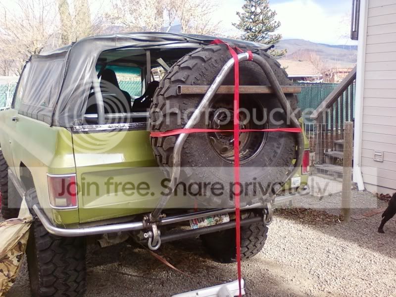

Steve - I took this pic today. The weather forecasters are wrong so often is disgusting. It's gorgeous out right now, they predicted 100% chance of rain all day... :doah: it's about 19" to the bottom of the tire, so subtract about 1.75" from that and you get total clearance on fairly level ground. It's about 32" from the ground to the top of the tire - kind of a big step, but not too bad. :)
I'm thinking it might be cool to use some 1/8" plate to make a little toe-grabber step on the stinger so I can more easily get up there... we'll see.

i was gonna say something bout a toe grap/small step pad before i read the end of your post. or almost like a collapsable tube step that could come off the end or that could slide into the square support tube, and then slide back in and secure when not in use. might not be worth the PITA. probably just easier to do a small little toe spot with like a 2 or 3" droppad.
