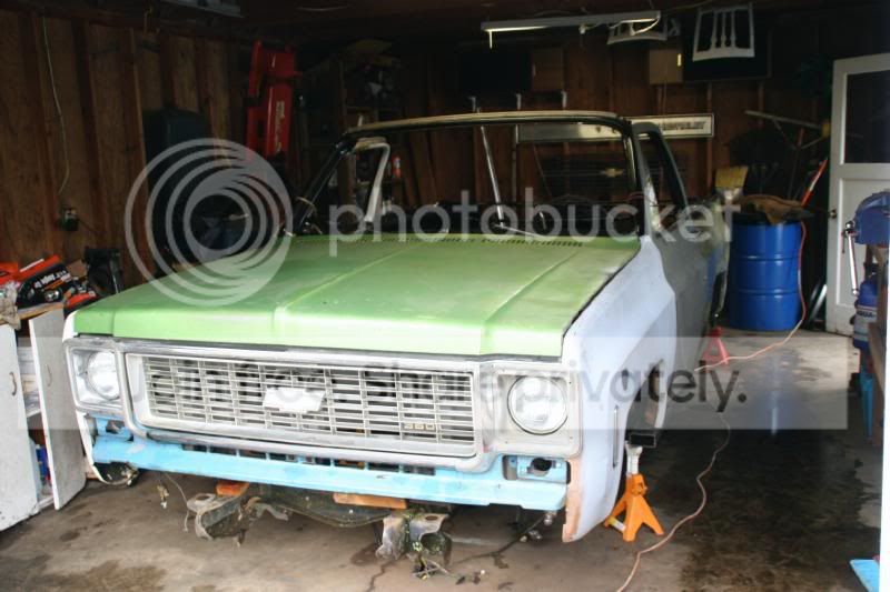

went up to camas, wa (about 20 min from north end of portland...) and picked up a core support and front fenders. the ones i had received with the truck were just too rusty to deal with. these are virtually rust free.
got the fenders cut down so that they fit over the sliders. still need a bit more persuasion from the grinder, but they're looking good. on my '83, the fenders are welded to the slider. i don't like this, because obviously it makes it impossible to remove the front clip. since front clips are so easy to remove all in one piece, i'd like to keep that ability for working on the truck in the future. i decided i'll weld a small plate to the slider that sticks up and is flush with the fender and then bolt the fender to that little plate. this also makes the fender easily removable when it needs replacement.

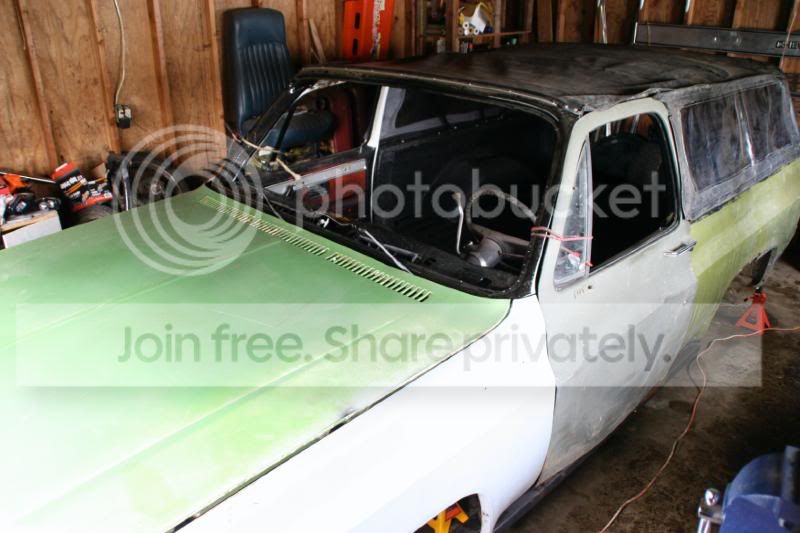

i also decided to see what it would look like with doors. i think i've decided to just go ahead and do half doors with soft-tops. the majority of the weight in these doors is most definitely in the glass and crank mechanism. besides that, i'm cutting 5 inches or so off the bottom, so there really will be very little metal left anyway...

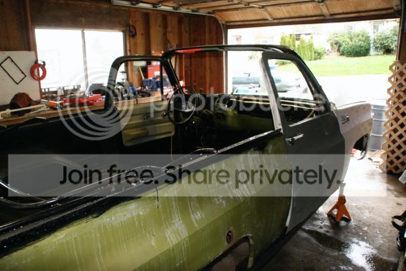

these are the doors from my '83. i've been a dumbass and took them off a few weeks ago and decided it wasn't worth the effort to put them and the top back on even tho it rains all the time here and i have to drive to work in 40* weather/rain at 5:30am. :D
then i put a couple boards across the door sill and put a seat on it and just sat in the truck for like 30 minutes dreaming about driving it. :D i didn't make "vroom-vroom" noises... but i should have. :wink1:

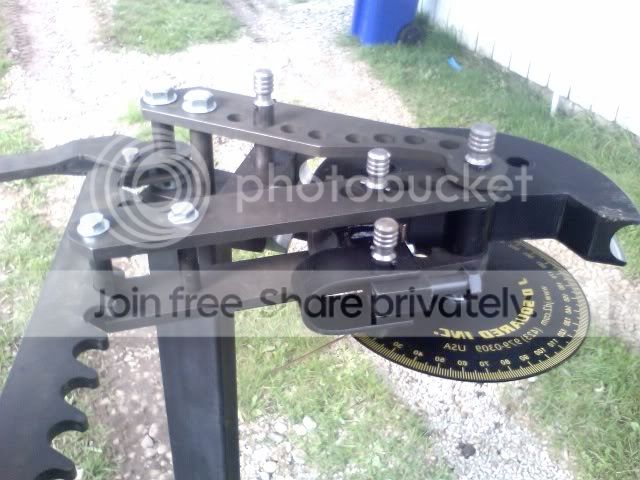

:D let the bending begin!!!.......... (next month when i can afford the tube :o )
no, they didn't print the lettering backward - i took the photo with my computer which operates the camera like a mirror would. :doah:
