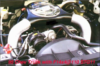

similar to this
i plan on building something like this but instead of that dryer ducting, just form some thin wall 3" aluminum tubing.
It's all in my head still, and the details arn't all there, but it should be similar to this setup.
i guess you don't do much mud, huh, savage? those intake hoses look like they're headed somewhere pretty low. i'm using the stock location, which is pretty high, and i had water in there. not enough to stall the engine, but enough to make it hiccup.
well, it'd be for for 83, it's diesel so it doesn't do awesome in the mud, but it gets the job done. I'm building it for rocks, my 79 pickup is the future mud truck. i would run the tubes to the factory intake tube holes in the radiator support holes on each side of the radiator, which arn't all that low considering the height of the truck. they are at my shoulders, which isn't saying much since i'm not all that tall, 5'8 on a good day:haha: .
thats the low budget idea i had in my head, i just wanted to run some 3-4 inch bendt tubing into my cleaner assembly. very cool though harry.
