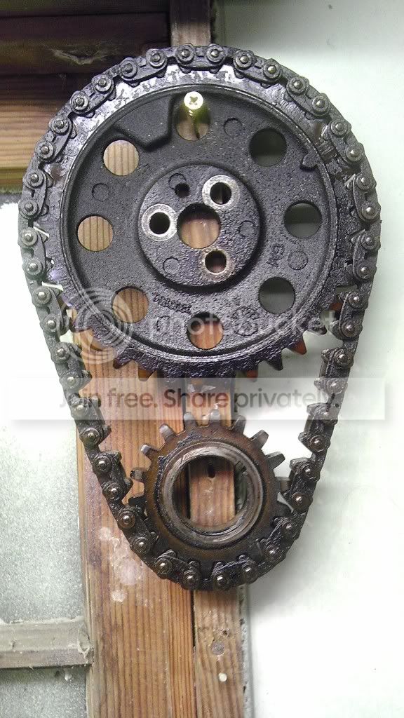

the factory style silent chain you have in the video is crap. thay stretch out in 500-1000 miles of new.
hope you got a nice roller chain thats pre streched.
and felpro 1 peice pan geasket is the ticket. :thumb:
I just went with a stock style chain but with a steal crank and cam gear. Im sure it will last as long as i need it to. I still need to return my oil pan gasket for the cool one.
cloyes street true roller is only like 30 bucks or so at orileys, Im sure that the stock replacement is within 5 or 10 bucks of that. Thats the cheapest chain I will run, granted I dont like taking my motors back apart.
Yea this one was 12.99. The original lasted 110k miles. Im sure this one will do the trick until i either sell it, or drop a 5.3 in it.

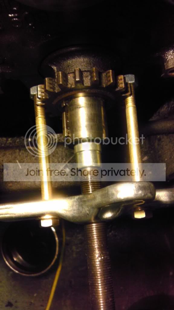

Being creative for pulling the crank sprocket. Worked perfect.

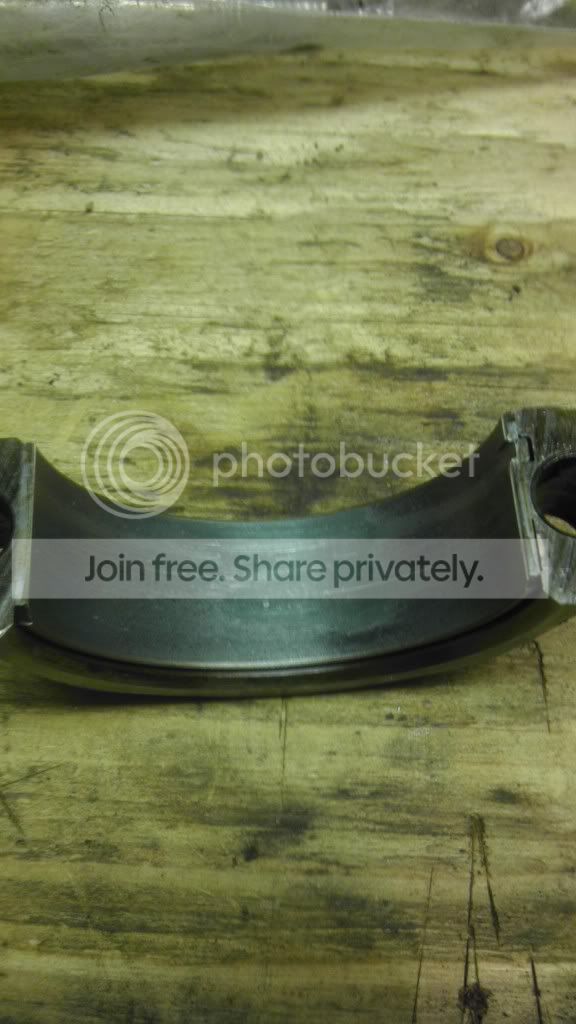

One of the bearings. They all looked pretty good and ALL plastigaged out at .0015.

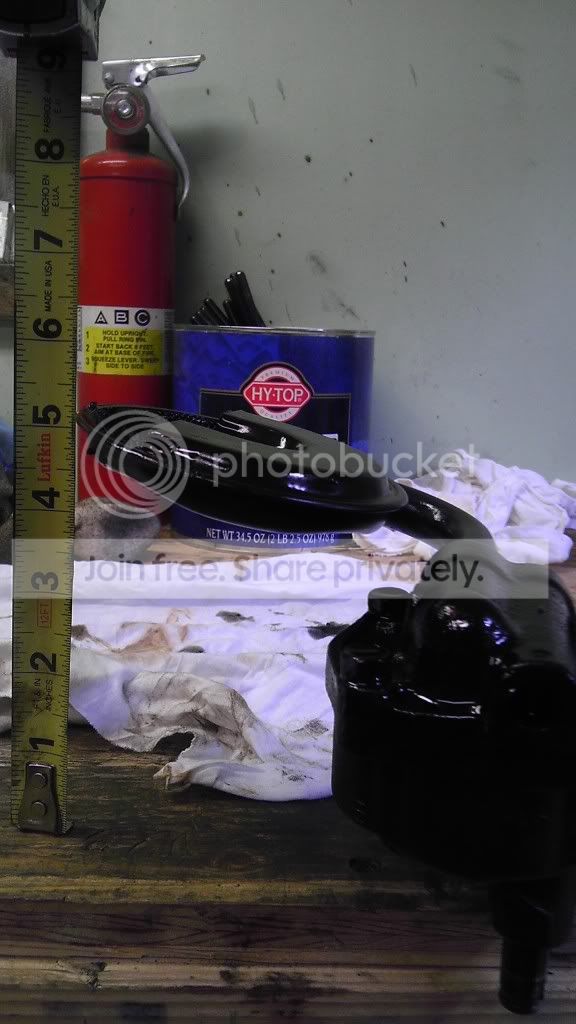

Measuring the height of the pickup tube for re installation into the new pump.
And the old chain.

I've had running small blocks that had such slop in the timing chain,that I was able to remove the chain without unbolting the cam gear!...and a few were not making any noises either,one had rubbed a hole thru the timing cover and cause an oil leak though!....most of the OEM cam gears with the nylon crap on the teeth were "bald" ,all the nylon ended up in the oil pump screen,and the aluminum teeth under them were so worn I felt it was a miracle they still ran,and hadn't jumped time!..
A quick way to get a crank gear off,if you dont ned to re-use it--I use a sharp chisel ,put it right over the keyway slot in the crank gear and one or two good whacks will split it there,they crack pretty easy being grainy cast steel..learned that method from an old timer at a machine shop who felt using a puller of a gear your going to toss anyway was a waste of time...I've done many that way without a hitch since...
Good, thing you noticed and replaced it. Dad bought his old 73 with 30k miles, and everyone knows the mechanics truck doesnt get fixed. He was going to a jobsite up in leavenworth conveniently a block away from my brothers house, and the truck just let go and layed down. Got his worth out of the factory nylon chain, it was either 230k or 270k miles!
You probably already know this, but just to make sure, be absolutely positive you bolt that rod cap on the same exact orientation on the same exact rod you removed it from, torqued to spec.

I did them one at a time. Removed the cap, plastgaged it, cleaned off the plastigage, then torque the cap back on. Lather, rinse, repeat.
That works perfect. Were you sure to put it back on the same orientation? (If you notice the bearing is offset toward one side to clear the radii on the crank journal, not to mention tolerances of the bolts locating the cap on center)
If I am preaching to choir then nevermind, sorry about that. :waytogo:
