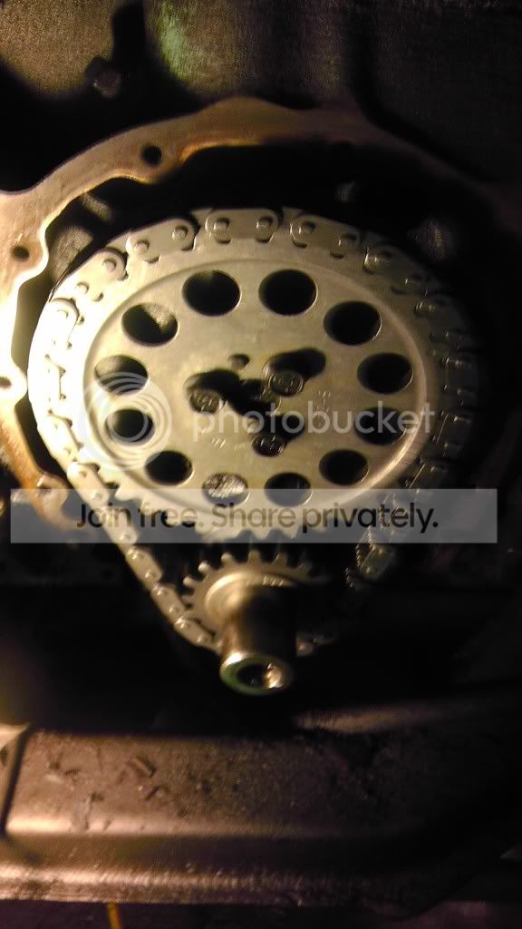

Here is a pic of the new cheapy timing chain. Sorry no finger bang video! Anyway, last night i got the timing cover, harmonic balancer, pulleys, and water pump re-installed. Tomorrow night i'll start in on the valve seals. Hoping to have it wrapped up by saturday but we'll see.
EDIT: I know the dots arent lined up in the pic. Or even in sight for that matter... But trust me, they were before i rolled the motor over some tightening the cam sprocket bolts.

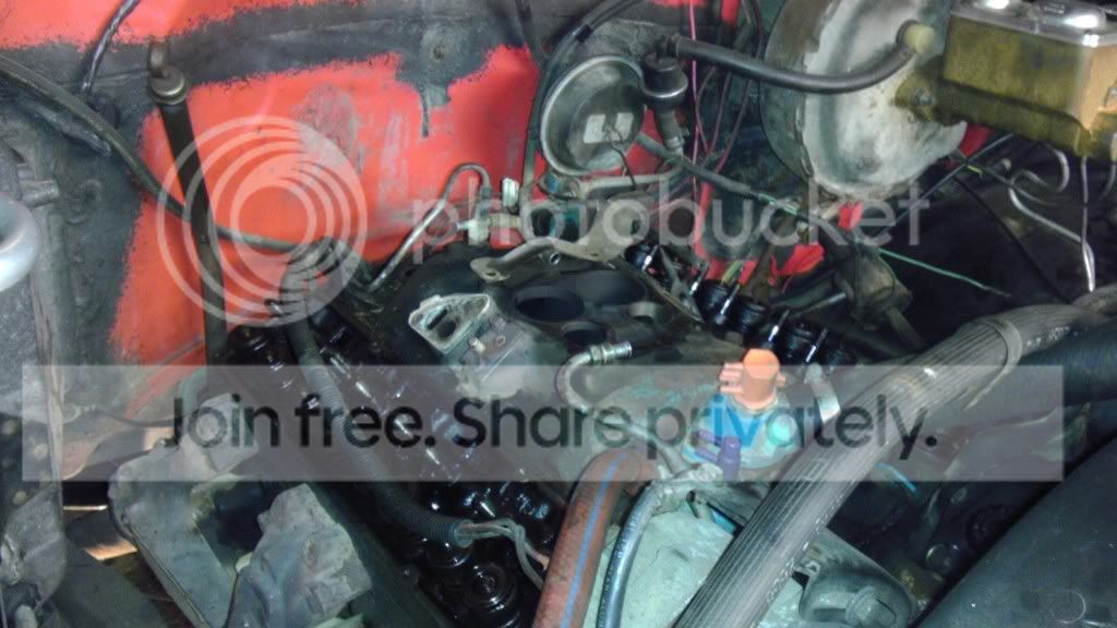

Got all the valve seals in last night. So tonight i will work on re assembling the valvetrain and re setting the lifter preload. Then just work on putting everything back together. Still gotta go to the parts house for the oil pan gasket and rear main seal before i can button up the bottom end. Also gotta dick around with the distributor because i noticed that the centrifugal advance movement is really sticky.
Good progress tonight! Got the rockers all back in and adjusted, valve covers on, and all the accessories back on, and the radiator in. All i gotta do now is put on the carb, stab the distributor, and put the oil pan back on.
